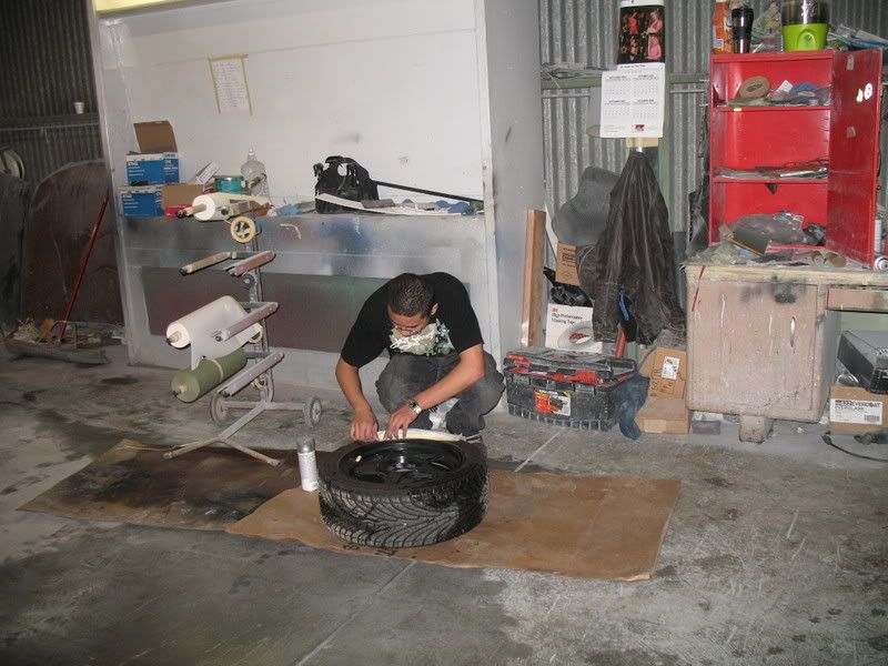

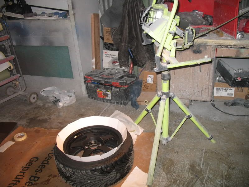

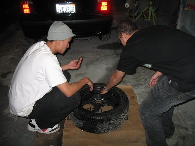

heres is pics getting prepped
From here

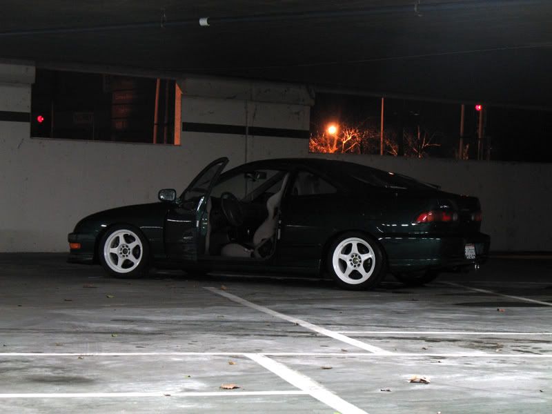

Here are the results...
If anyone needs help to paint their own wheels, feel free to ask questions.
