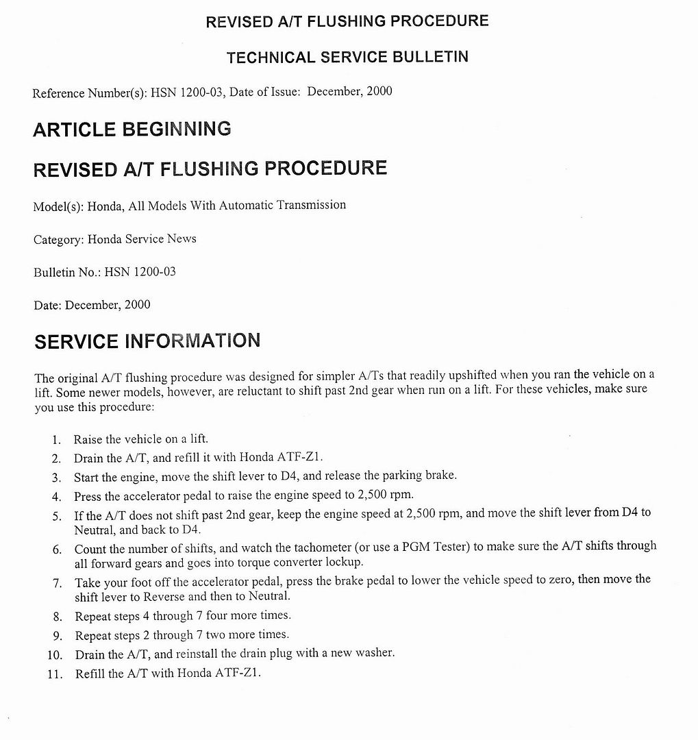

Ran by this info and thought I update people in case they didn't already know. They also have one regarding running vehicle on lift so I'll see if I can post that as well because this refers to doing it off the ground.
Anyways, here it is:
