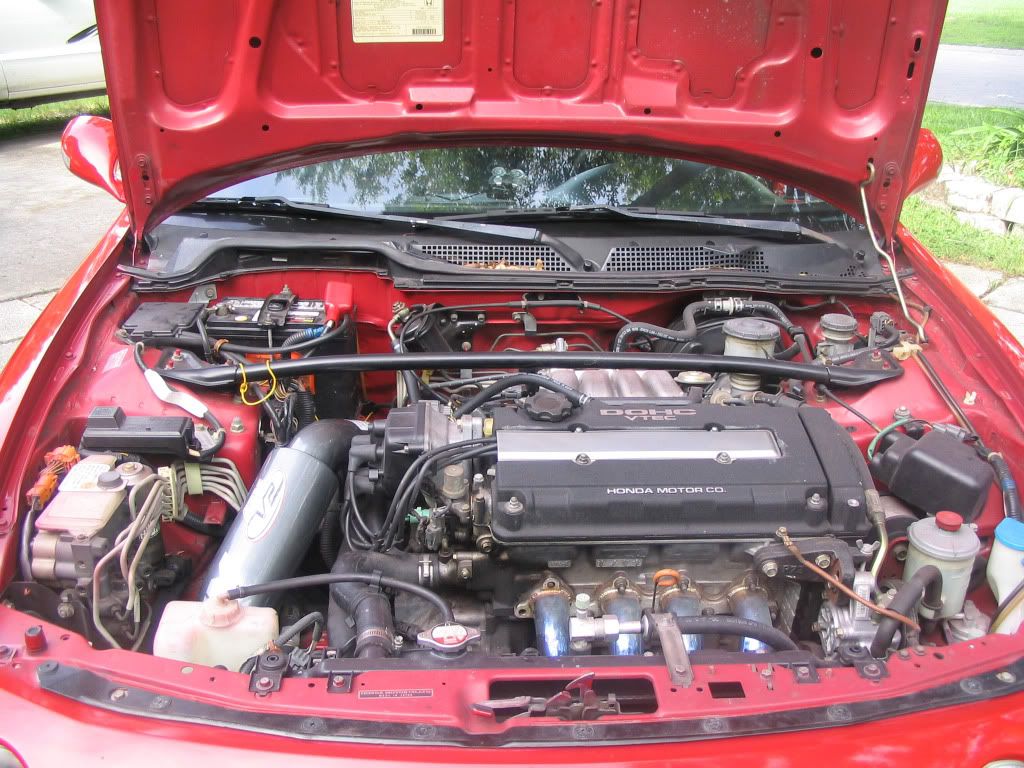

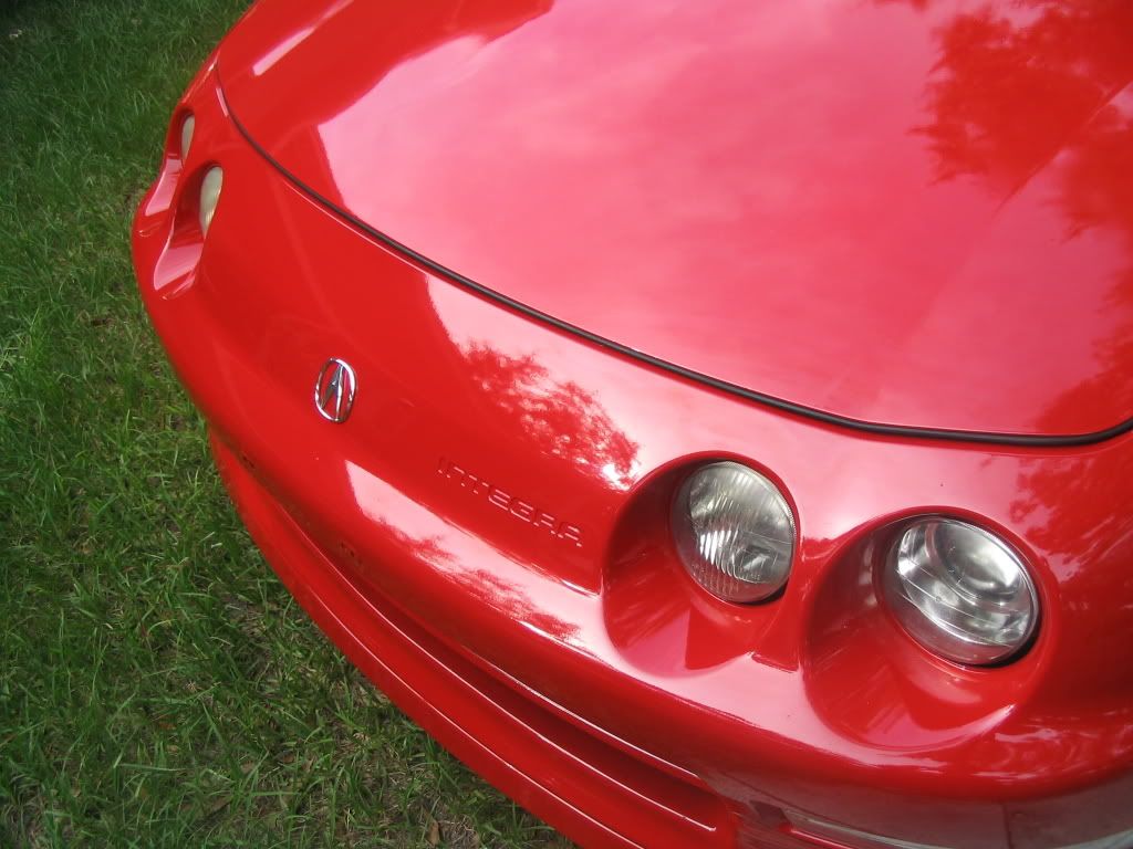

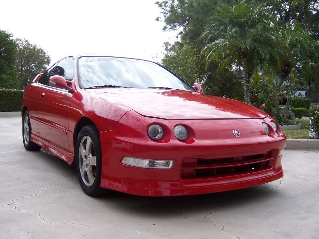

This is what I started with
I bought her 2 years ago on ebay, she ran perfect and I loved her, she stayed stock for about 2 months before I added the front lip, side skirts, spoiler, intake, headers, and a cheap muffler (biggest regret)
she got lowered early last year on koni yellows and eibach sportlines, great smooth ride, and rough when I want it to be

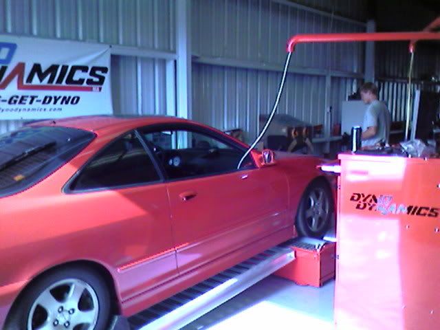

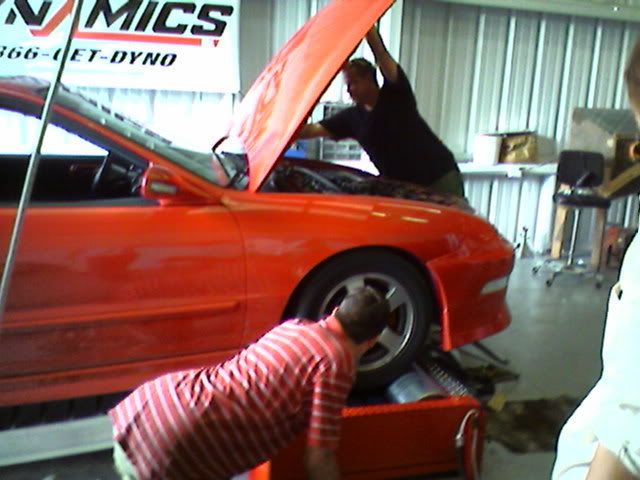

one of my friends owns a shop so I got it dynoed for free
here are some pix
more info about the shop here ellisautoworkz.com - ellisautoworkz Resources and Information.
Surprisingly she pulled 153.8whp with over 160k miles
I got it dynoed just to get an idea of what I have before the build
if anybody is interested I will upload the graph if the next few days
