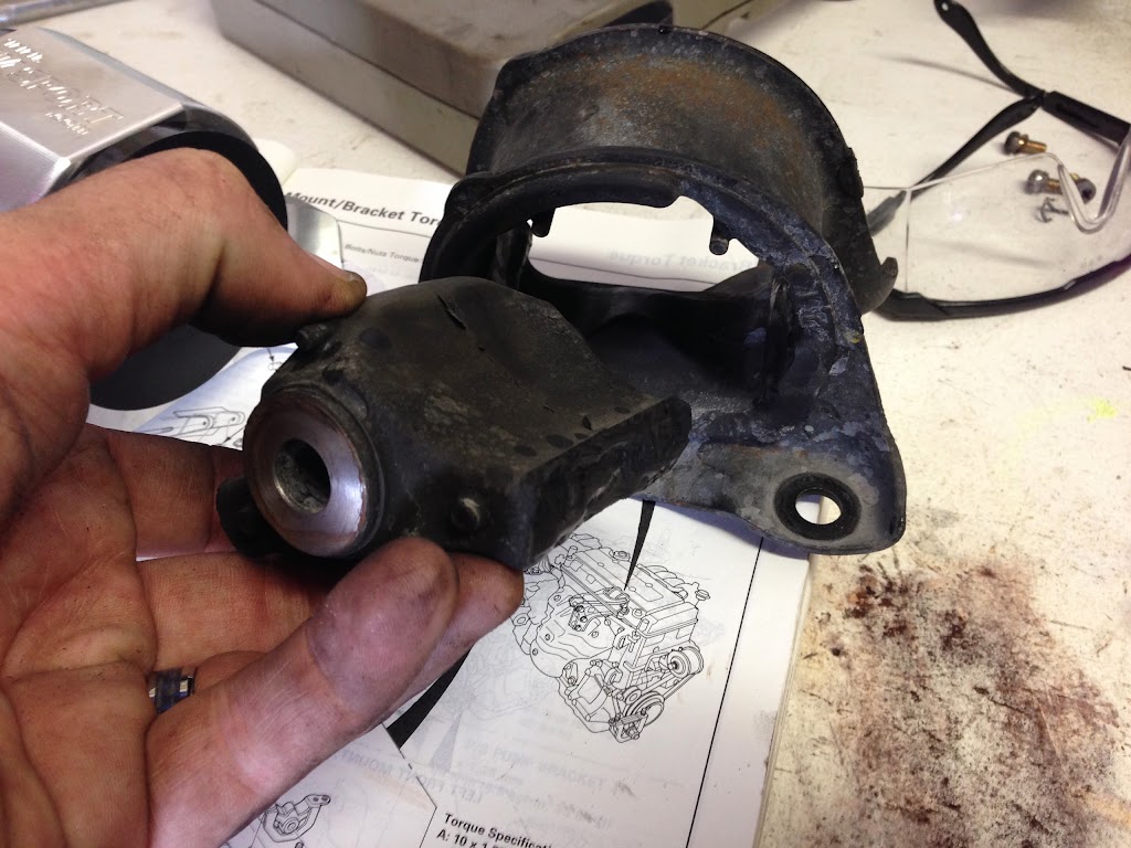

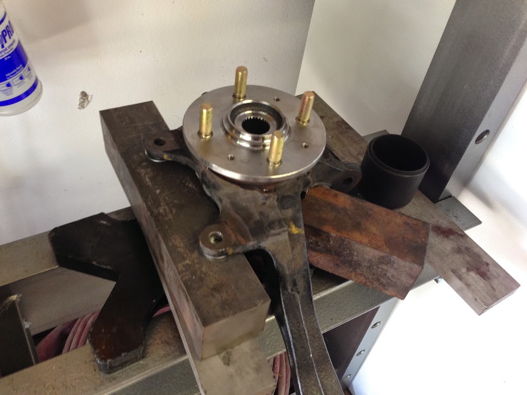

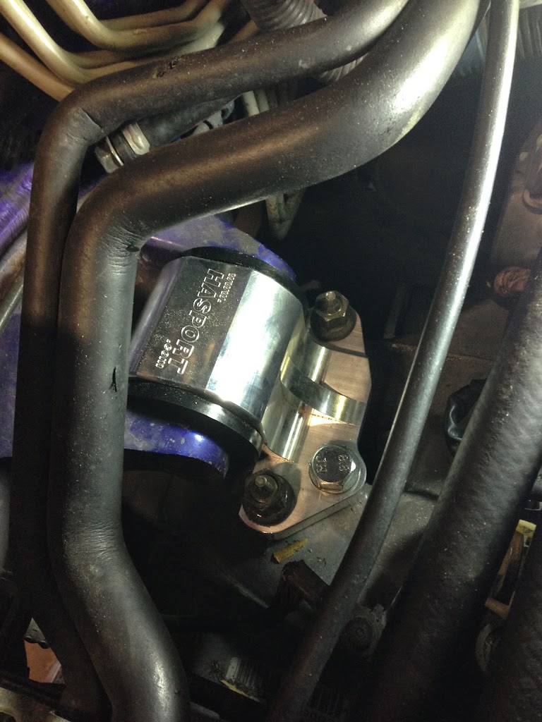

Work from today:
Pressed in my passenger side hub and bearing
Got the rear engine mount out, wow what a pain in the ass, but it was time with head and SC out..... as you can see it was TOAST
Passenger side was a *****, nothing a piece of wood and mallet didn't fix
