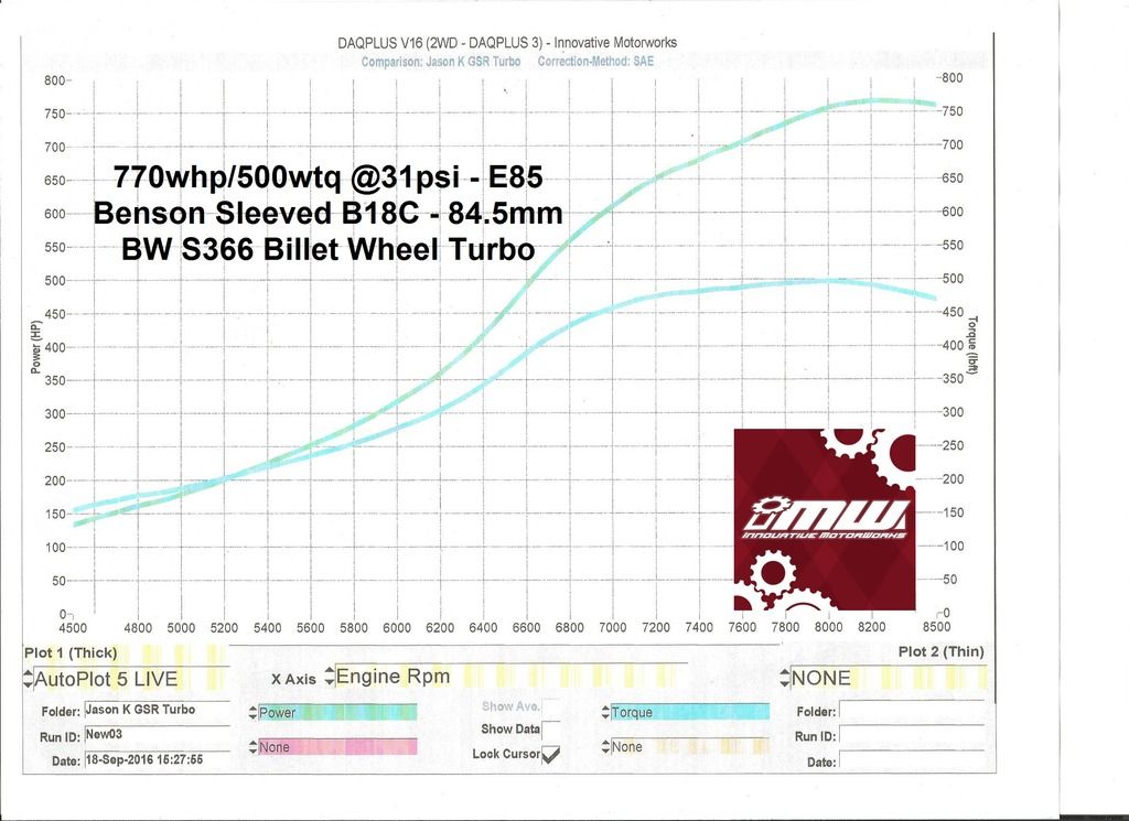

If you recall, the dyno numbers were:
Before: 780whp/480wtq @ 34 psi
After: 770/whp/500wtq @ 31 psi
Take notice to the HP down by 10. This time around, I shut-the dyno down. This specific dyno has a max rating of 500wtq. Not revving it out as much kept the torque down a bit, being able to finish the tune. Ultimately, it's making more power, at a less PSI. This is due to the increase of compression, and .5mm more bore.
