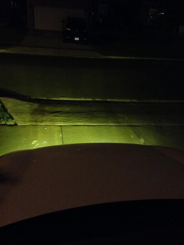

Last night I installed a set of knock-off OEM style fog lights on the car. I got the yellow lens housings, and 3000k 35w HID bulbs for them. I think they complement the 6000k HID headlights rather nicely. I'll try to snag some better pictures soon. I did manage to integrate two relays for the fogs, so that the combination of a switch, the ignition, and the parking light circuit all have to be on for the fogs to turn on. I wanted to avoid "flashing" the fog lights every time I locked / unlocked my car, as my Viper alarm fires the parking light circuit for these events.

Love the yellow fogs

Thanks for the notes on the fogs. I had a hell of a time getting them to align right, and getting them to seat right in the bumper. I guess that's what you get for a $50 knock off.
