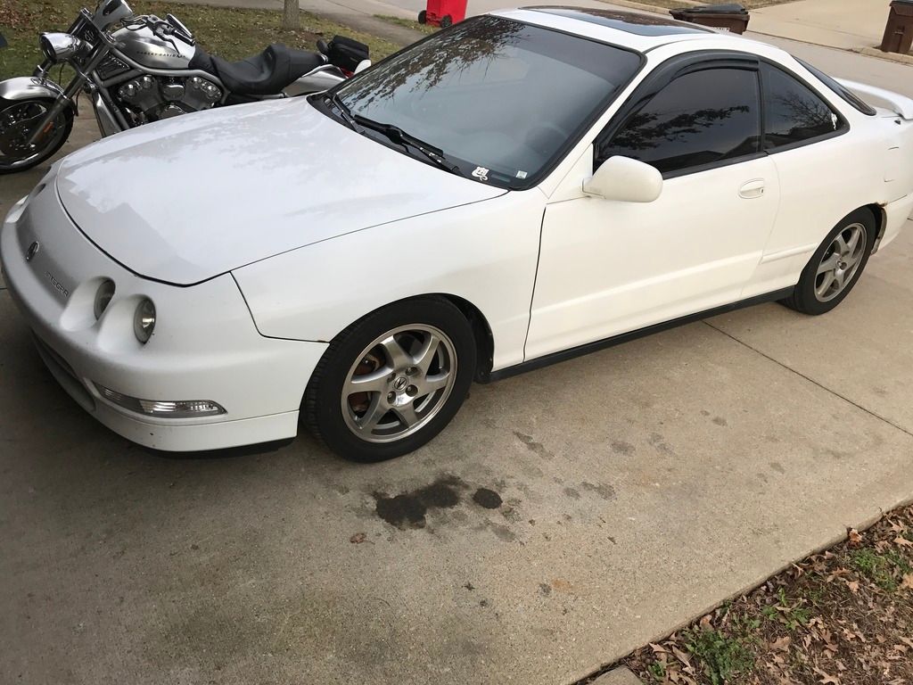

Took the day off Monday to tend to the outer door. Started off with a round of a Bondo Plastic Metal to fill in the majority of the gap. Once that was cured, and sanded, and wiped down, did two rounds with Bondo Spot / Glazing putty to smooth it over. Once everything was flushed, masked it off, sanded, and primer. Let the primer cure for an hour, hit that with 800 grit, and then onto the DupliColor Color Match paint.
It's far from perfect, but I think this being my first real project anywhere close to body work related, it turned out pretty damn good. There is a low spot or two that will need to be skim coated again, that really didn't show up to the eye until the paint was dry. They're not glaringly obvious, but I know they are there. I'll tend to them once I get the rest of the dings / dents smoothed over when prepping the rest of the car for paint.
The color match isn't perfect, but it's close enough to not be an eye sore.
