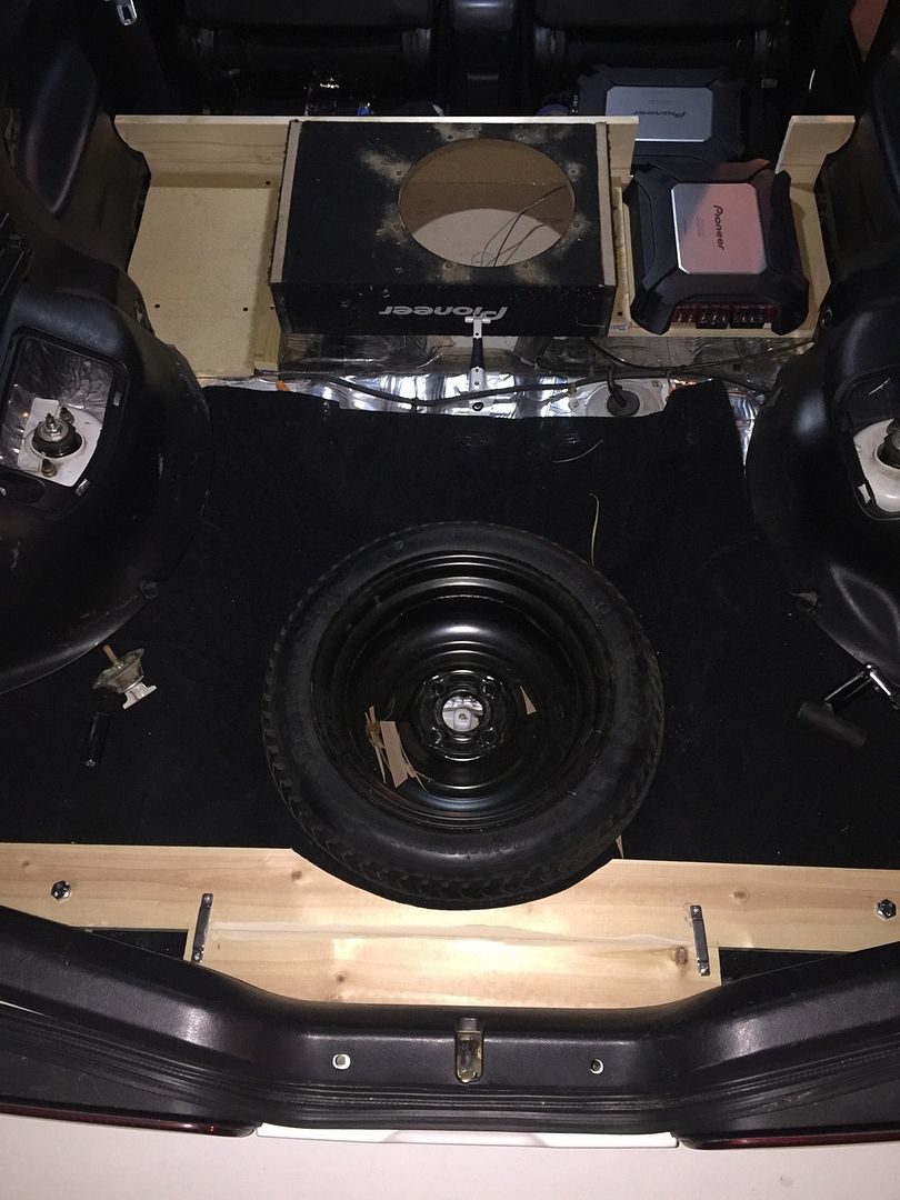

I've been chipping away at the back seat delete and new platform for about the last week or two. I spent a few hours one night, gutting the whole rear interior. Took me the better part of a day to get everything degreased and wiped down. I then applied 3 full rolls of Peal & Seal, to cover every square inch from the back bumper to the rear floorboards. I get that Peal & Seal may not be the best, but its cheap, and readily available locally, and is better than nothing.
I've been slowly working on getting everything cut and in place. Summary of the layout...
  • 12" Slim Subwoofer moved forward, and will be recessed into the floor.
  • 2x Pioneer Amps, stacked on top of each other (similar to how I had before), behind the passenger seat, recessed into the floor. I'll have an opening cut so you'll see the top amplifier, and an opening on the front "panel" for access to the amp adjustments
  • A small compartment behind the driver's seat, with a hinged lid, to utilize some of the dead space underneath
  • Hinged door in the back, to gain access to the spare tire.
So far I've been really fortunate, as everything is coming together quite nicely. I've used a mixture of 1x2, 1x4, and 1x6 to create the framework. I've got a couple of days of more rough cut / template work to do, and then I'll begin the final assembly. Once everything is fitted, I'm going to pull it all back out, sand it down, paint all of the wood black, and then wrap it with some bulk carpet that is on its way from StockInteriors to match the floor carpet I just put in.
I'm also waiting on new Pioneer TS-D1702R 6 3/4" speakers for the rear, and a Pioneer UD-G308 subwoofer grill.
A few pics of the progress... please ignore the "crap" everywhere in some of them, this is a work in progress. I'll post up some more pictures in the next week or two. I figure I'm probably 2-3 weeks out from having this project wrapped up.
Gutted, before I cleaned it
Everything cleaned, starting to lay down the Peal & Seal
Looking in from the passenger door. You can see the cut out window for the amps, where the sub will sit, and the compartment on the right.
Looking in from the trunk. Can see the rear brace, and where I layed some cheap walmart automotive carpet just to make the tire well look decent. Picture is a bit deceiving. The tire is "down in the well". The rear most brace is sitting on top, using the factory bolt holes. I cut a notch / curve in that rear support to make access to the tire easier.
