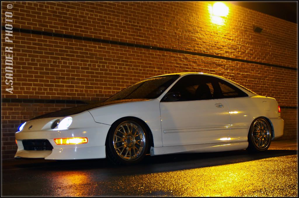

Oooh. Did you paint them yourself? If so it looks like it needed alot of preping, yeah? So many spokes...lol anyhow it looks clean. What was the procedures on painting them?
1,242 Posts
Discussion Starter · #7 ·
they are a 2 piece wheel so it was pretty easy just time consuming. i took the wheels apart. then striped the old paint with aircraft remover. sanded down what was left. then primerd and painted with high temp gold...it was closest to the color gold i wanted. i'm pretty sure it doesn't need to be high temp. then i cleared them with duplicolor clear. overall it took about 5 hours and was a lot of work. but i love the new look. def. something differen't.
