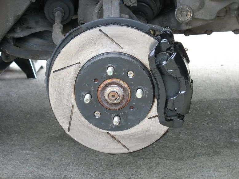

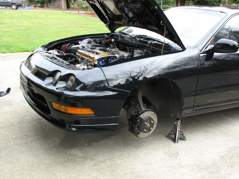

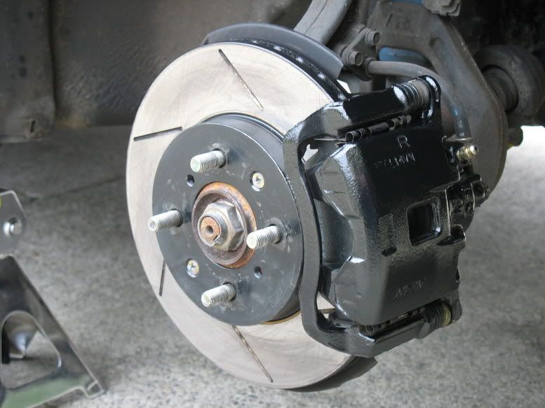

Got bored today so I decided to paint my calipers black using Duplicolor Caliper Paint (brush on). It was SOO easy to use, you don't even have to mask anything off if you're careful. No pics of the rear but you can use you're imagination. (In case you're wondering, those are the Centric Slotted Rottors and Ultimate Pads from our sponser Pro Parts USA, I'm very happy with the feel of this set-up) But anyway, here are the pics...
190 Posts
I got the caliper paint from Autozone for $15.99. I put 3 coats on each caliper and there is still 3/4 of the paint left. I wouldn't mind having to re-due it later too, it was pretty simple. You just have to make sure you clean the surface with some brake cleaner (included in the kit) and sand it a little to scuff the surface.
Thanks for the comments!
