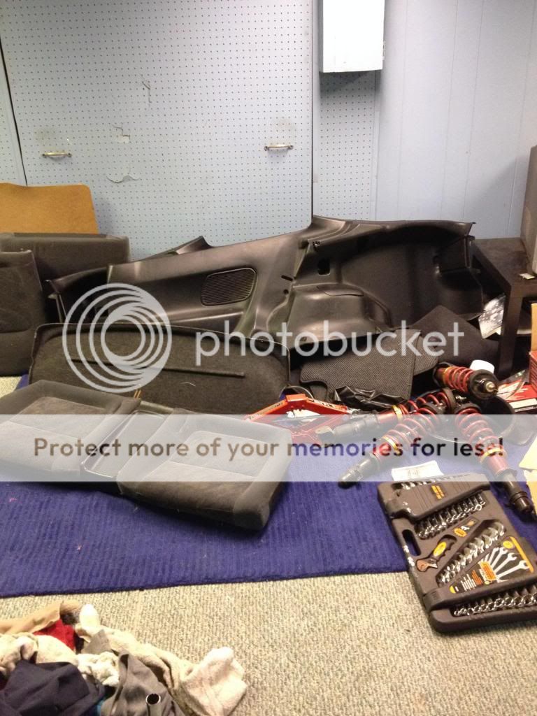

Can't forget the room shot..it's becoming a problem..
