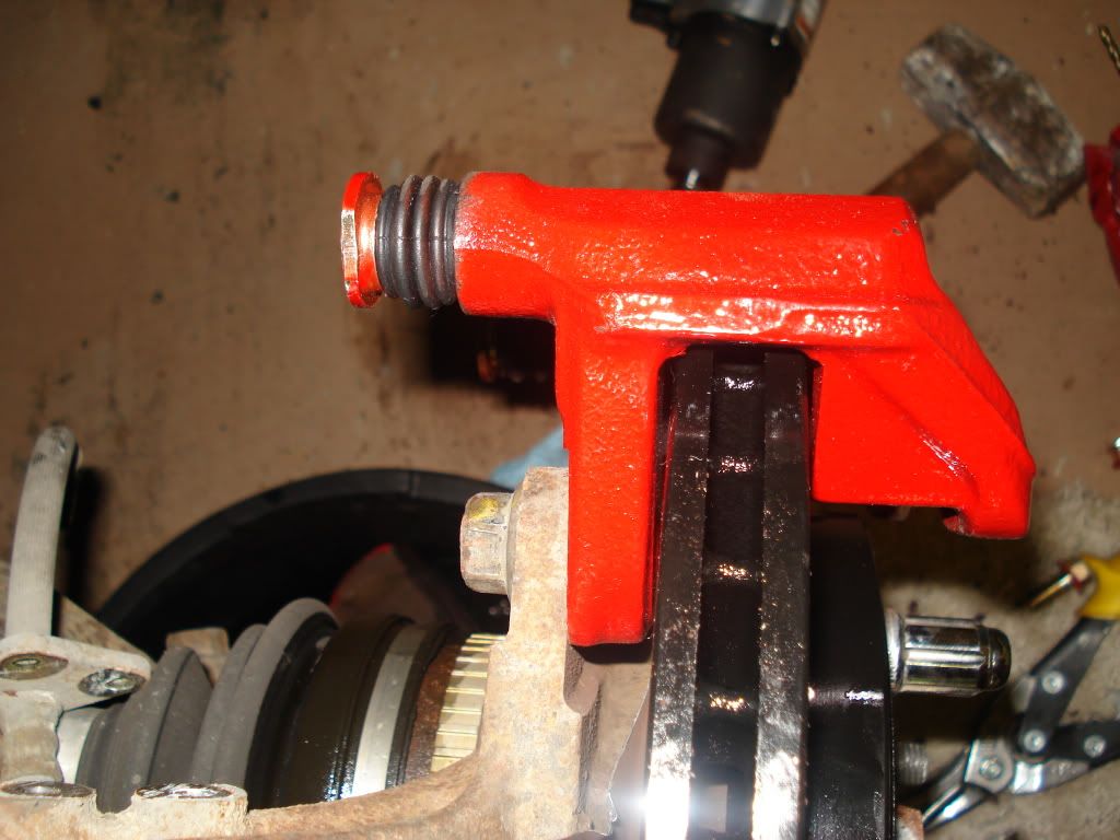

I have to agree- not pretty...and looking back, I'm pretty rusty (hahahaha) being that this is the most welding I've done in some 6-7 years. But hey - function > form :)
Indeed!! This has got to be the easiest, most straight-forward big-brake upgrade, ever. And with OEM parts to boot! Here's everything mounted - it just looks plain good:
I was honestly a bit worried about the bolt holes - I think they're 1 or 2 mm larger on the Coop rotors than the Integra's - but then I remembered that the center diameter is exactly the same, so no worries.
Here's the hardest modification you'll need to make - you can see here that the Type-R calipers are clearly larger and interfere with the dust shield:
Just break out the old angle grinder and cut here:
And here you can see fitment is good after the two cuts:
Still need to order the pads and the SS lines...but it's certainly coming along.
