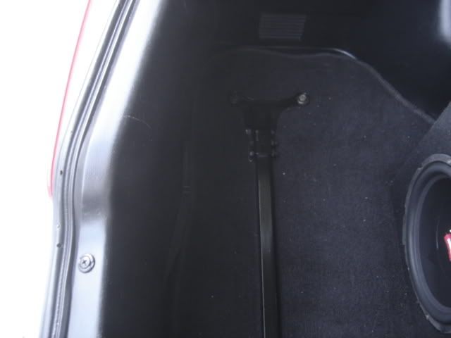

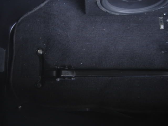

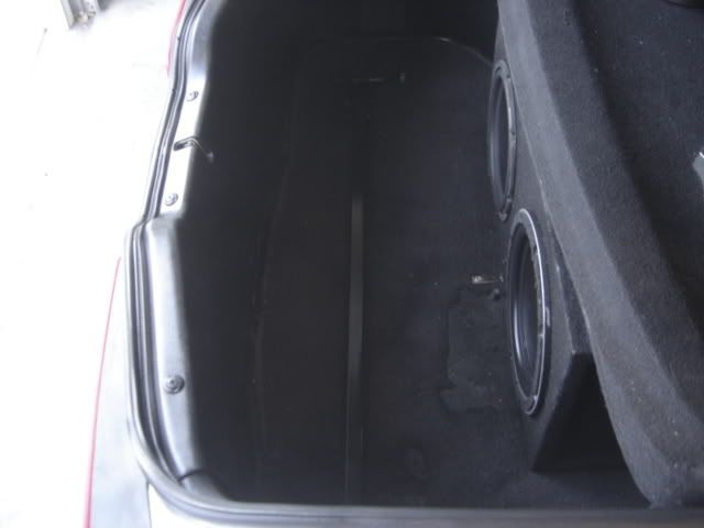

so i was out at pick n pull last weekend when i came across some style of a buick and it had a big ass front strut tower bar on it. I saw quite a few actually. So i got the brilliant idea of were i could use it and bought it. I dont have step by step or pics to explain my install but basically drilled through the trunk floor on all 4 holes. then through the carpet. ran a bolt through the carpet, put a washer on the top of the trunk floor hole, pushed bolt all the way through, threw on another washer, some lock tight and a nut for all 4 holes. the bar is sturdy as a mo fu**** and looks clean. I never thought bracing the unibody did as much as people hyped it to until i cornered after this install! sorry the pics are a lil dark

It looked like you bolted right next to the side of the metal frame tho according to this picture. hum, mind to take come pics with the carpet out? it'd be nice to share your bolt points.

Well hook us up wit a little more info!!! Maybe get the make and model of the car you took this bar from...Buick??
Post a pic of the car you took the bar from and the location of the bar so we all can be up on this new ish!!!
Dont be greedy now...spead the love!! I want to do the trunk floor bar mod but i dont like the look of the square aluminum bar. This looks good though!!

to be honest the pics make it look kinda ****ty but im actually really happy with how it turned out. and i was also thinking bout doin the home depot bar. so much happier i found this. And as far as the car goes i really dont remember what model it was. just go to a pick n pull or whatever u might have and look at the buicks. allot of them have the strut bar in the engine bays strut towers.
