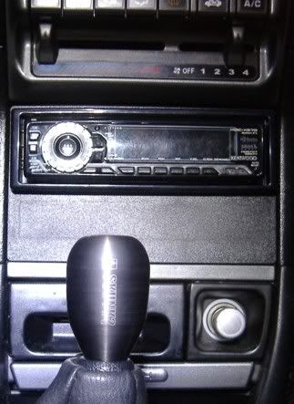

But, here's a little before/after comparison action of the knob installed in the car, w/ and w/o the short shifter. (See, I know you can't really live without pics... LOL)
Before:
(Excuse the drooping boot - fixed it with a zip tie.)
After:
Stupid nut. Back in the box!
