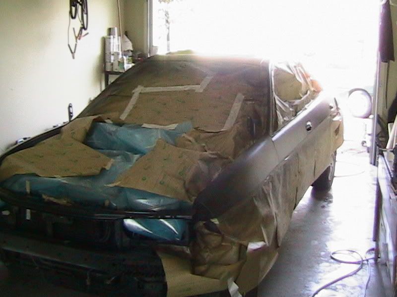

Here is what I did to the DB8 in the last two weeks of summer of 06.
The paint process:
Filling in dents, sanding and stripping the body.
Fabricating the lip.
Starting the paint process.
Bottom coat.
Clear coat.
Sanding and buffing.
Rear bumper drying in the sun.
90% finished product, just need side skirts and engine, suspension work.

Dupont paint and clear coat, husky spray gun, which is pretty good but my dad bought one of ebay that is made out of titanium and that works alot better and doesnt waste much paint like the husky because of the HVLP, also it almost doesnt leave orange peel, sucks he got it after my car was painted. I finished up with sanding with 2000 grit sand paper and polishing with a drill foam pad and 3M polishing gell I dont rember what it was called but they have it in O'riley auto parts, its in a white plastic botle.
