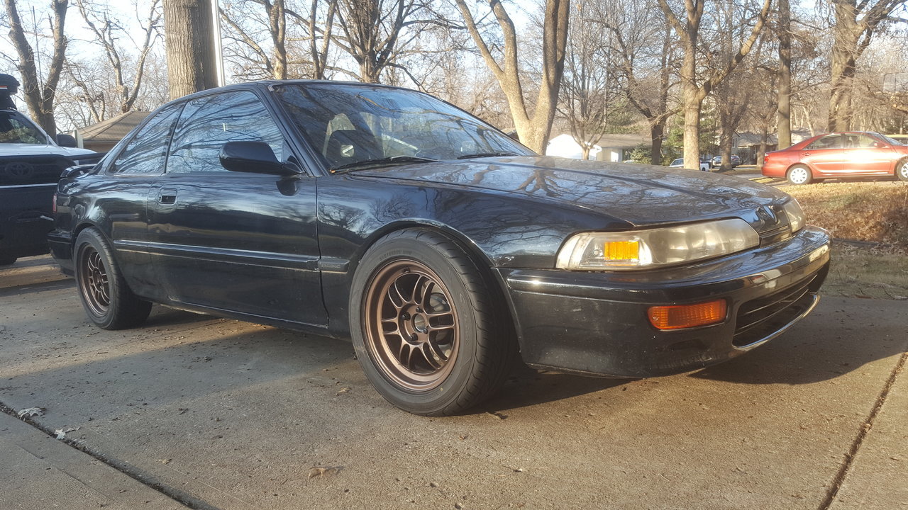

Currently I picked up a 93 DA9 LS with a pretty clean body, minor rust on the front fenders and hood. Interior was missing a few pieces.
Mechanically the car needed work but ran albeit rough. Synchros going out and low compression, enough to drive it home and around for a while before the alternator went dead.

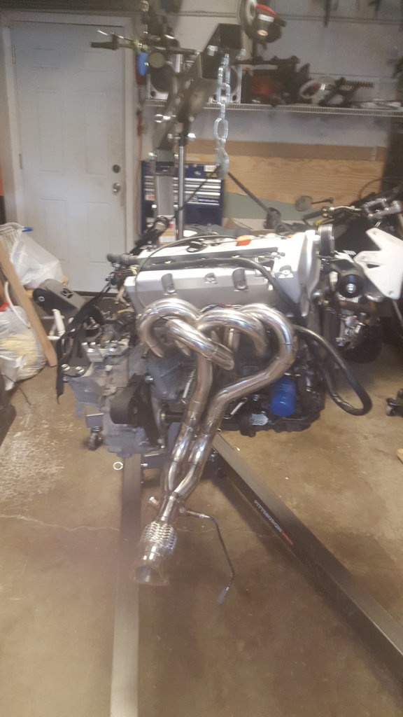

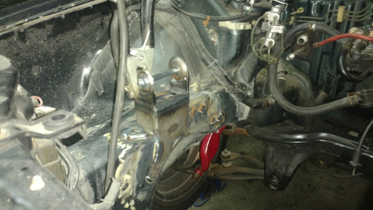

Here are some photos of work that has been done slowly but surely. The engine is in the car on the mounts. My supermoto race season finally came to an end so there will be free time on weekends home now to get it knocked out. Probably forgetting some stuff on the to-do list

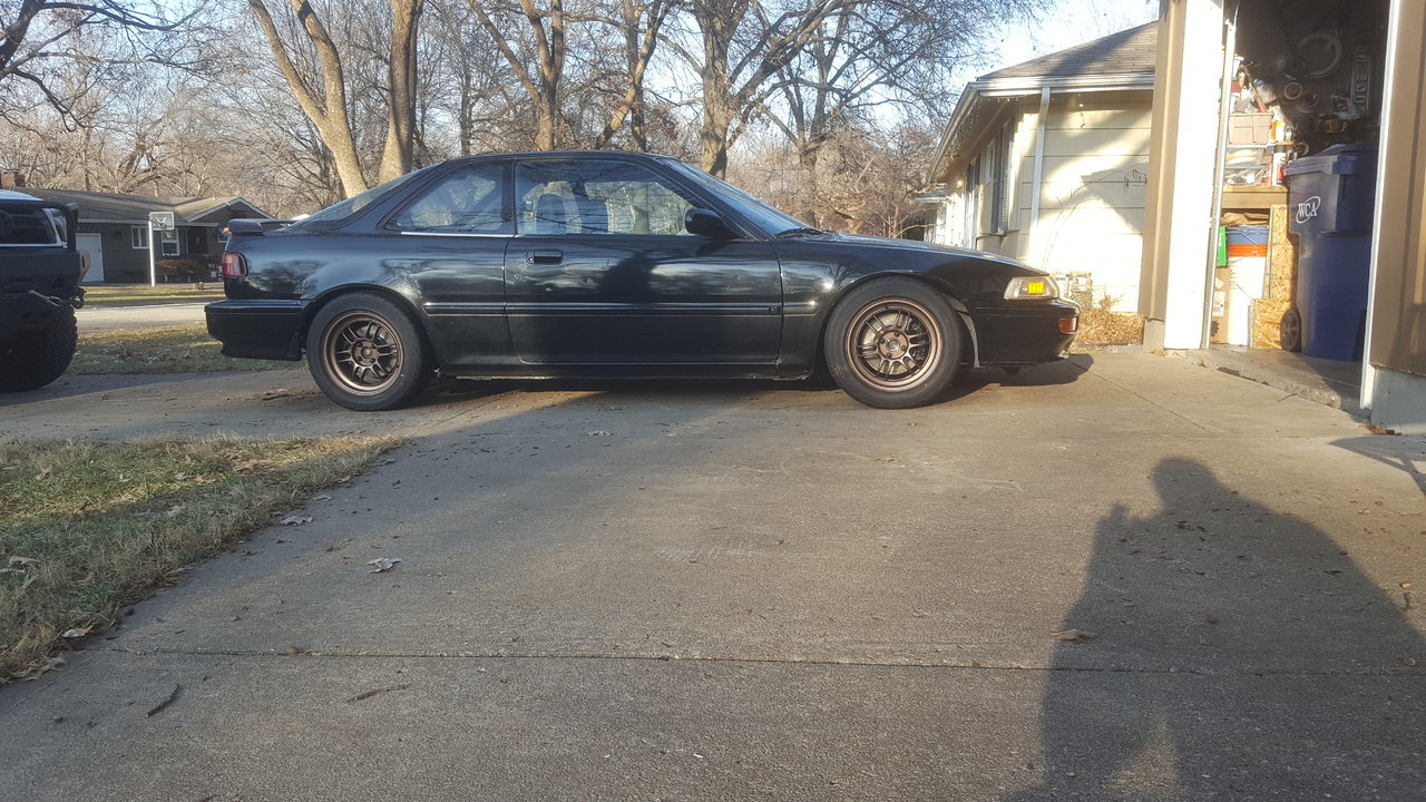

The car is alive! after so much work and time it feels great to have this car running. Albeit there is still work to do.
I need to get a real tune (placed a stock 440cc injector tune and just adjusted the injectors down to 410 for the rdx).
Also had the oil light come on during a subsequent start up. Unsure if it is a true issue or not so i ordered a prosport oil pressure gauge and acuity 1/8bpst to /18npt cube. While i was at it ordered a wideband as well for standalone use since i dont plan to have a laptop with me at all times.
Having a small leak issue with my cmc. Need to get my thermal exhaust modified and on the car. Bleed the coolant, replace mtf.

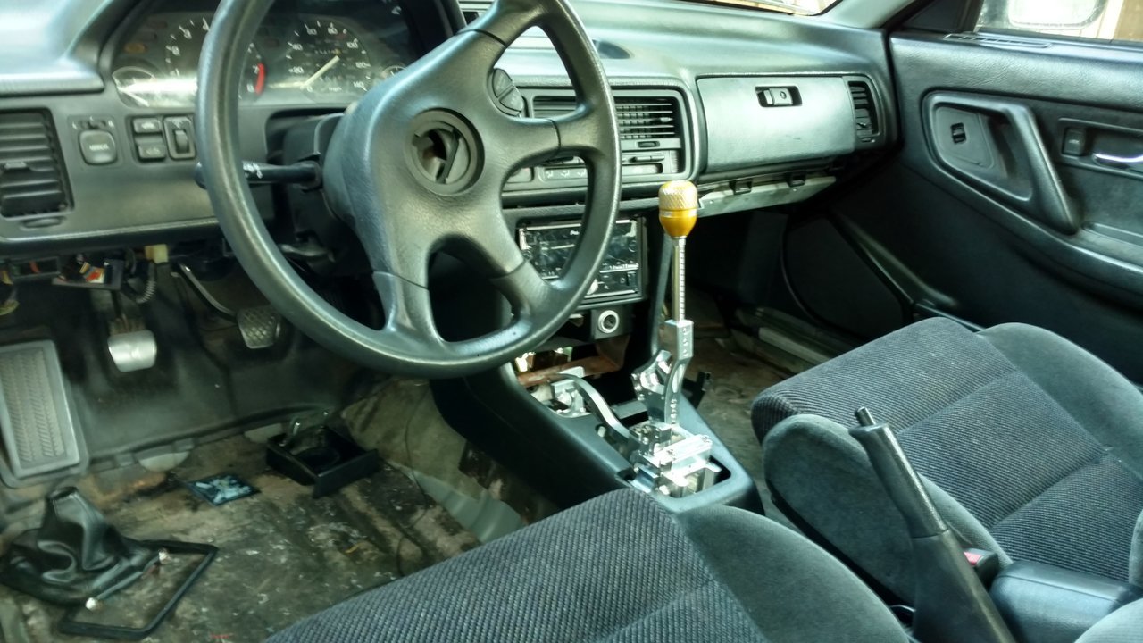

Opinions on no interior floor carpet? it semi-bothers me not having it since i think it looks cleaner but bed liner may be enough to give it that look without having to track down a replacement stock floor.
