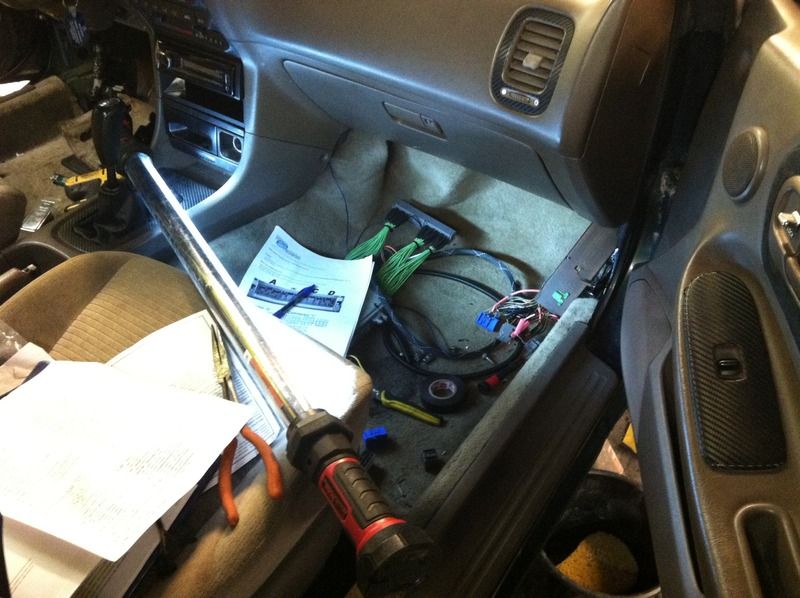

then i went back to working on my ecu issues. i have 3 wires that have pulled out of the ecu crimps. and i see why now. i was reading up on depinning and i tried a wire that was intact in the ecu plug to make sure my technique was good. check out the crimp on this wire. see all of the corrosion? i'm sure a lot of these are like this.
i am having a heck of a time getting the pins that fell off the wires to release from the ecu plug. i dont have the luxury of pulling the wire to remove the crimp. i tried turning it straight up and down in hopes that it would fall out via gravity and i had no such luck. i tried releasing the pin like in all of the depinning videos and pushing it out the back from the front, that didnt work either. i'm actually starting to cause some damage to the plug and i really dont want to do that. any ideas on how to go about repairing this? i have 2 wires on the large gray plug and 1 wire on the smallest of the 3 ecu plugs. this is getting to be really frustrating. i want to repair it properly without causing further damage to the ecu plugs.

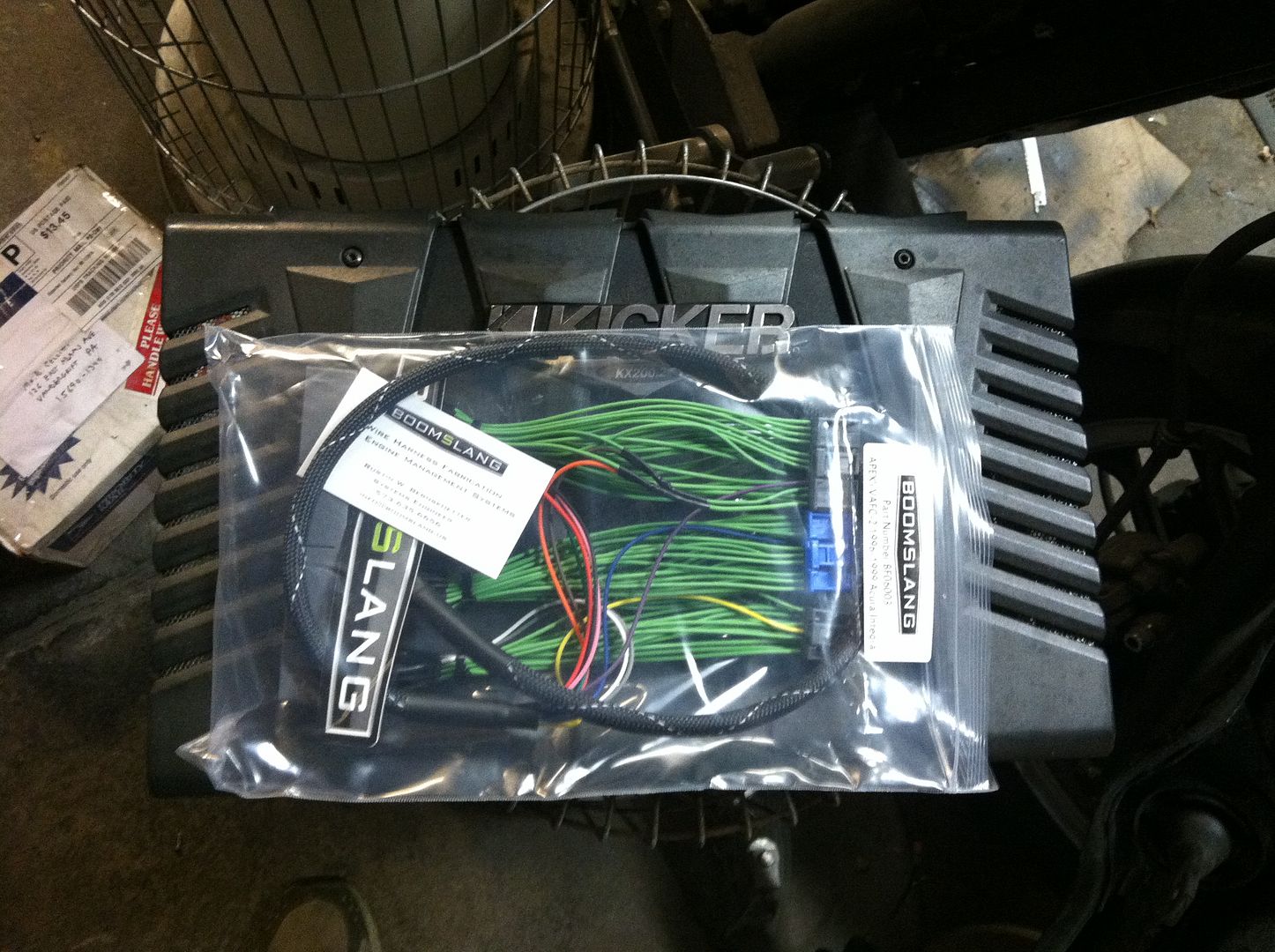

speaking of frustrations, i ordered up this guy to stop my frustrations with re-doing the connections to the harness for the vafc2. so now my frustrations lie with the ecu plug repairs only.

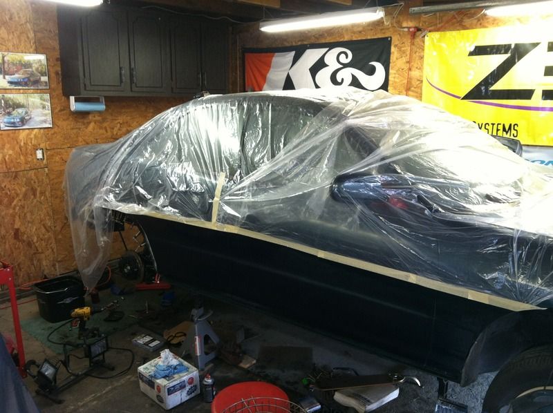

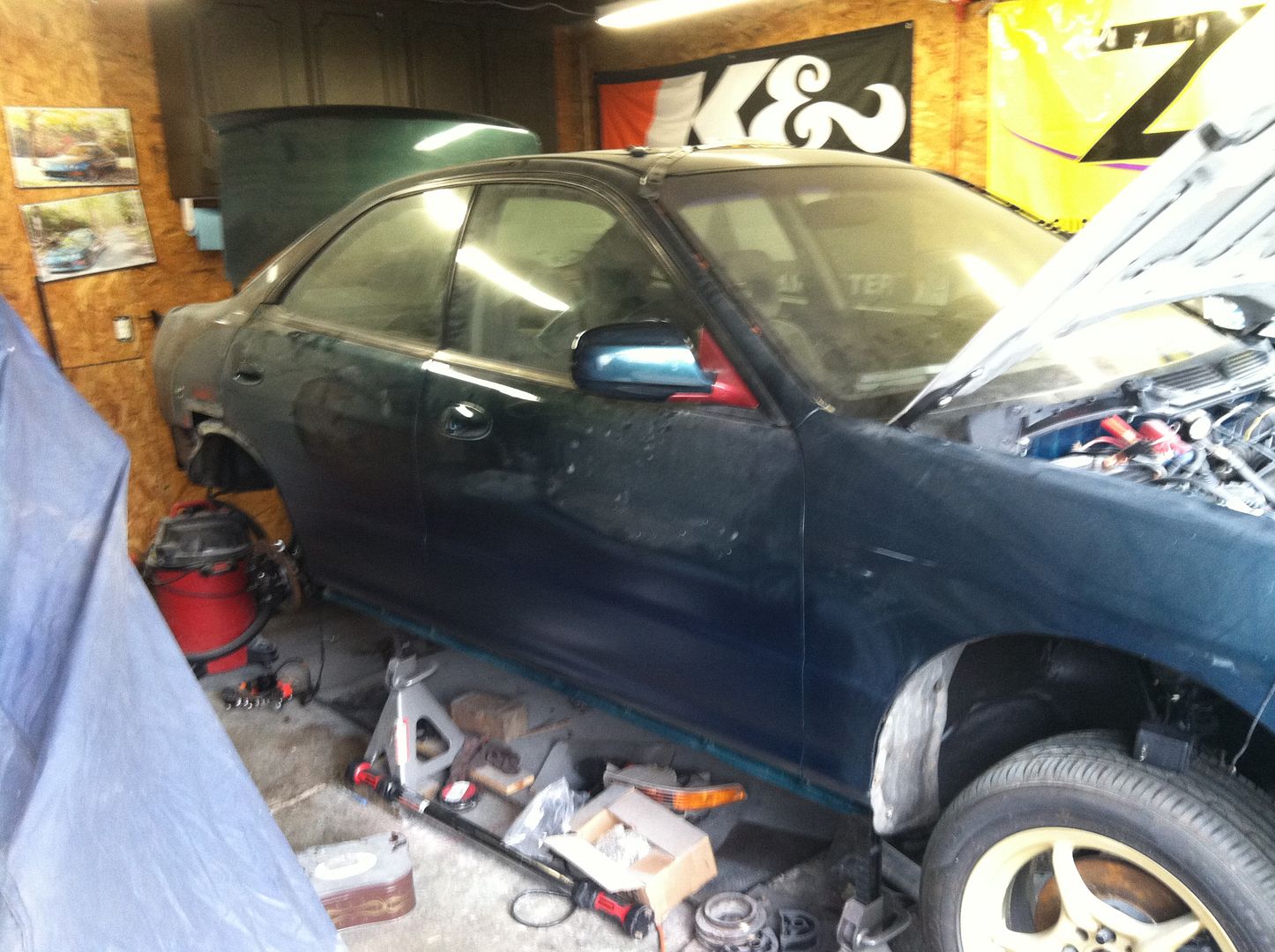

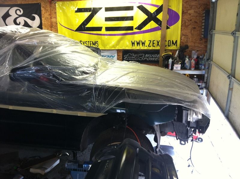

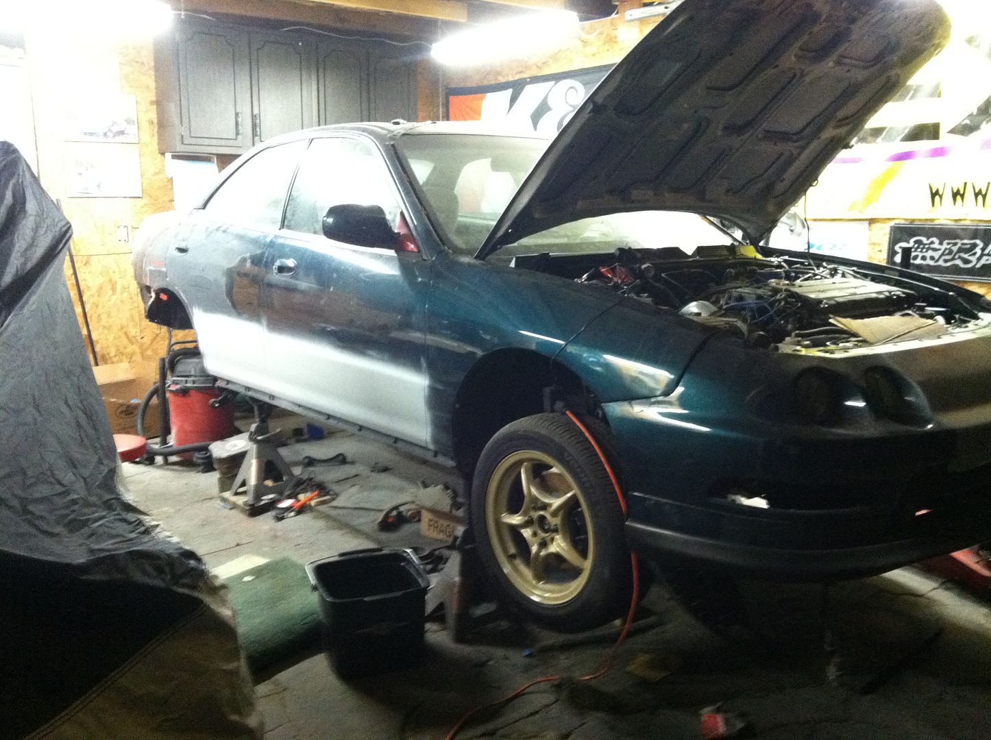

so i finsihed up the work in the garage this weekend with some painting and general cleaning. this is just rattle can paint, the same color i used for the engine bay. still needs a little clear coat. its not perfect, and the body work is not 100% final yet, but in the event i dont get the car painted next year, this will hold me over in the meantime.

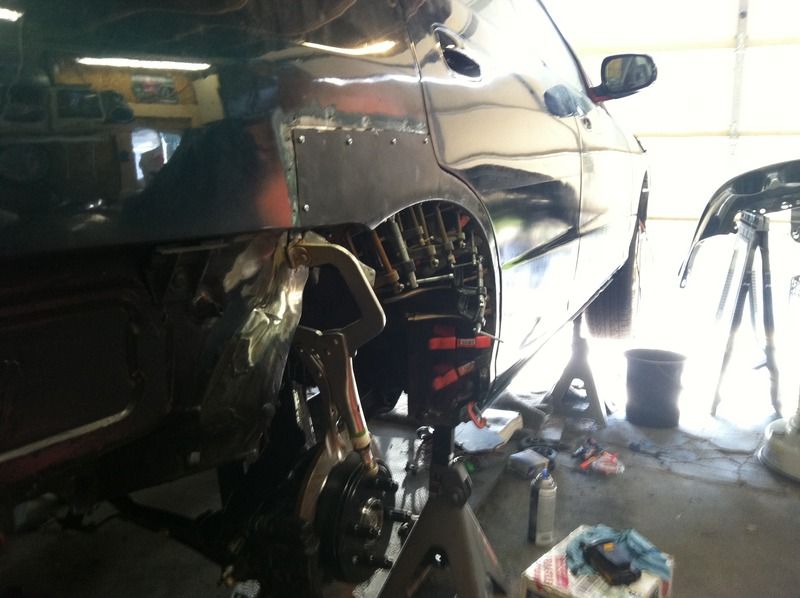

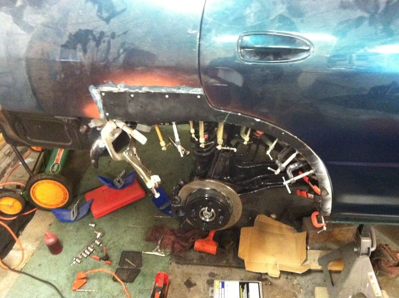

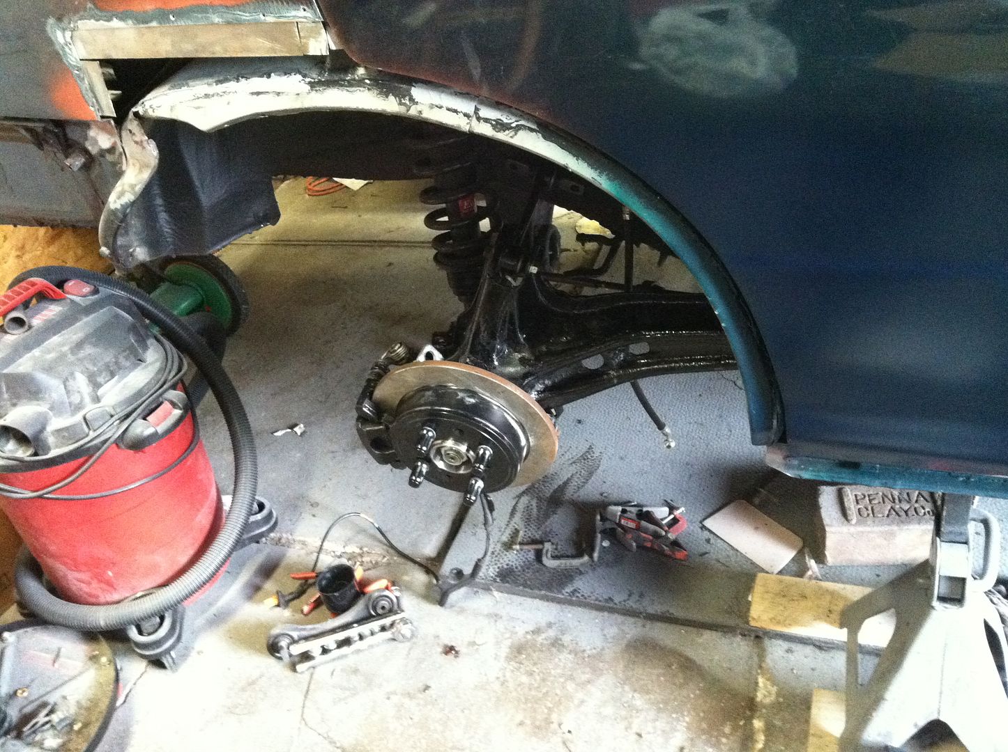

re-installed the rear calipers, brakes, and most of the rear suspension on the passenger side. driver side will be installed when i have most of the cutting out of bad metal done.

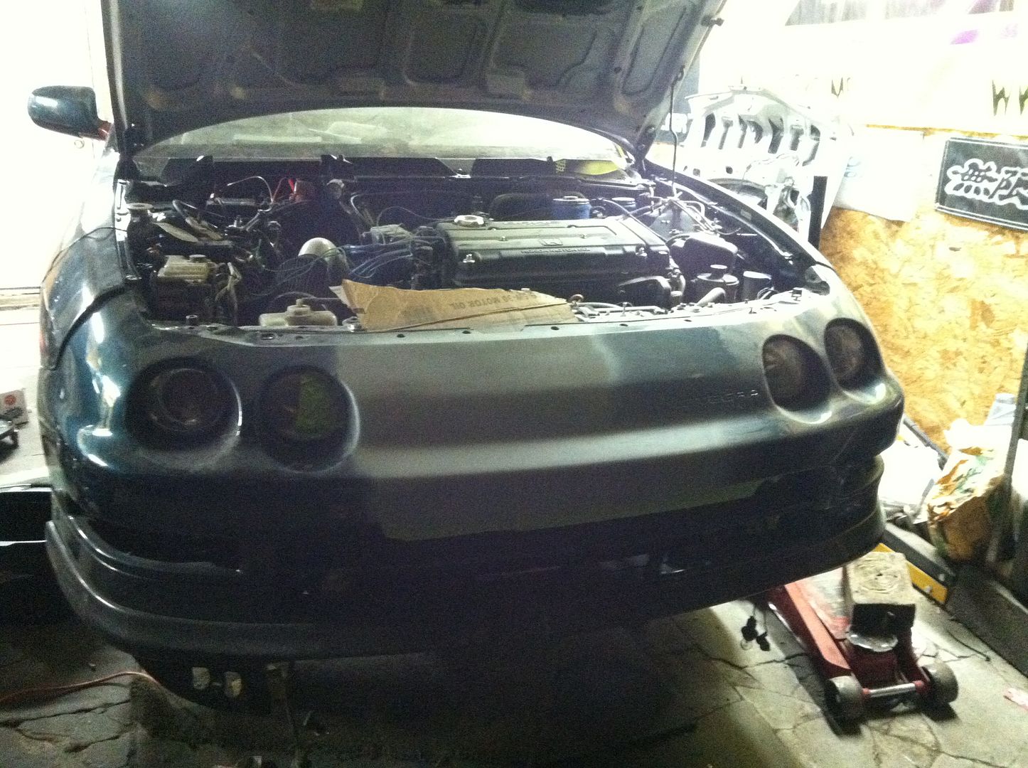

and if anyone has some front bumper fender mounts they don't need, i could really use some. these ones are toast
also completed the re-installation of my jdm fogs and finsihed wiring up the switch. as soon as i get some new bumper mounts for the fenders, that bumper can go back on the car for good for now.

so...i messed with the wire harness this weekend. My depinning technique is perfect now, i had A LOT of practice lol. Here are some pictures during (the pile of wires on the garage floor is from the donor plugs):
i made the repairs to the 3 or 4 wires that had pulled out of the ecu plugs, i depinned each wire one by one and reinstalled them to the new plugs that arent all battered up. finished the project, plugged the VAFC2 in to boomslang harness, got everything all hooked up and turned the key to the on position and NOTHING HAPPENED>... very disappointing. so i double checked all my connections, tried again and still nothing. so next i double checked the vafc2 itself. hooked it up straight to the battery and it turned on and went to the main menu etc... ok....what in the f*&%... i'm going to double check my ecu plugs and for sure verify i have every wire in the correct spot, but that shouldnt really affect the vafc unit just turning on. after i double check that, i may have to reach out to boomslang for some trouble shooting advice with their harness. such a fiasco.

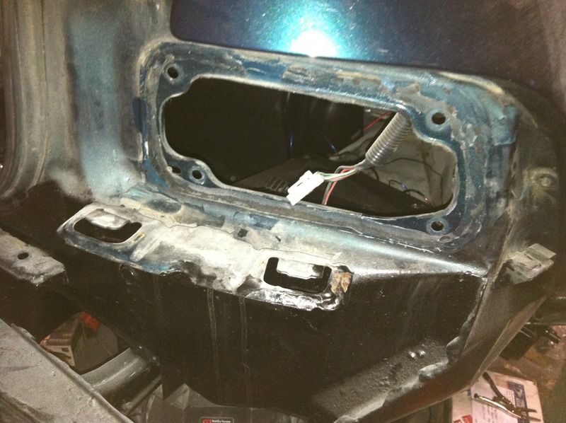

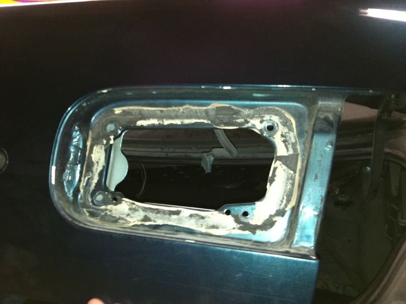

question time! i started cleaning out my parts boxes and decided if i install the talights and new gaskets, i can throw out another box and free up some space. didnt really notice what the previous owner did until yesterday. instead of new gasekts, it looks like they used some sort of sealant where the gasket should be. its not like a regular rtv, its about the same consistency of seam sealer. any advice on how to "easily" remove this? i tried a razor blade, and it works but its slow going. but, maybe thats just how this is going to be. luckily, its only like this on the inner taillights.
outer almost cleaned up
inner, not so much

Got a heat gun?

sure do, you think heating that junk up a bit will get it off faster?

Couldn't hurt. That's how I debadge cars with similar material. Heat then fishing line the peel.

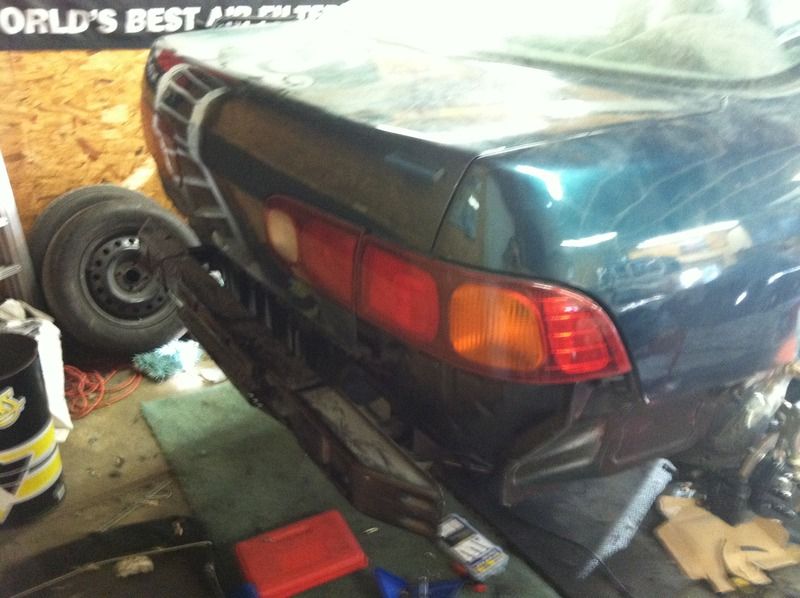

i didnt get any pictures, but the tail lights are now installed, thanks to the suggestion of a little heat. its not perfect but its way better than it was. so i've come to realize that i'm not going to get both quarter panels done this year. i'm running out of good, warm weather. so i'm going to hopefully finish the passenger side, mangle the dirvers side back into some sort of shape, ghetto patch up the one hole and put some rust proofing over it for now. that way, if/when i get this car running i can go get it inspected and worry about just the quarter panel next spring.

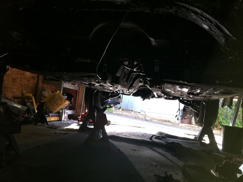

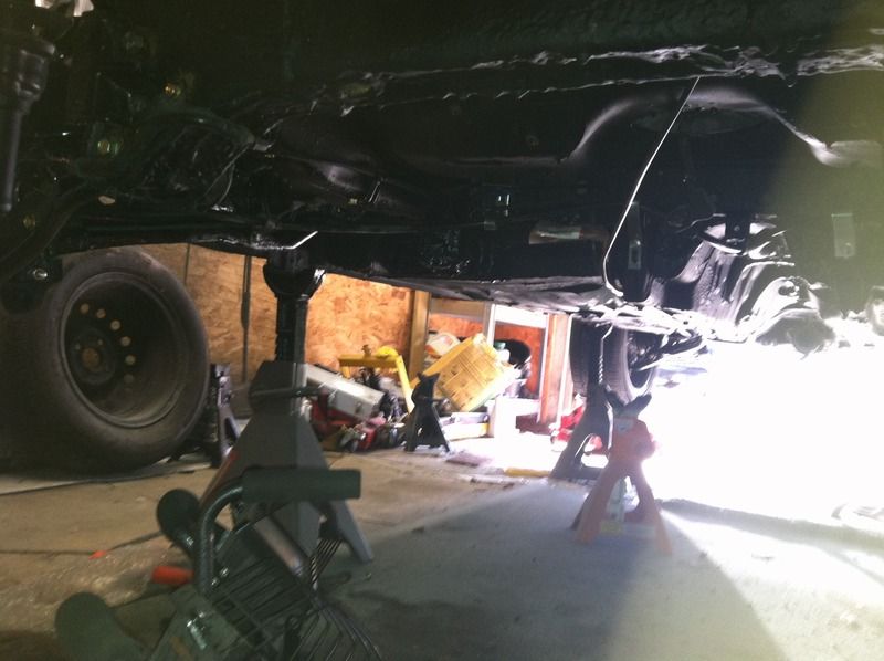

i connected all of the brake hoses and finished up all of the rear suspension pieces and got them bolted on to the car. i just have to finish mounting the ebrake cable on the driver's side and mount the rear sway bar and suspension is done. then hopefully this week i can bleed the clutch and brake systems. Which reminds me i have another question. i replaced 3 hard brake lines, all of the hoses, and the abs unit. is there anything i need to do differently when i approach bleeding the brake system? or just got about it like a standard brake bleed?
so here is my new game plan if i can get this electrical issue straightened out. get the brakes and clutch system bled out, finish bending the one fuel line for the tank, throw in the tank with the new fuel pump and sending unit, attach the filler neck, throw some gas in the tank and at least pressurize the system a couple times to check for leaks. then, i'm going to attempt to throw on the exhaust and get this thing test fired. that should really show if i have any electrical issues...or any other issues for that matter. so if all goes well, and i'm sure it won't, i can get the car test fired fairly soon and hopefully go get it inspected and continue working on it here and there until next spring when i can put on the driver's quarter panel.

regular updates first. *all the brake hoses, cables, etc.. are finally mounted where they are supposed to be. *these pics suck, but they are there. *
just need to trim the one fuel line and bend it in the correct direction and the fuel tank is ready to go in. i clear coated the areas i "roughly" painted with duplicolor close enough color lol. *it doesnt look great, but it will hold me over if i cannot get the entire car resprayed next year.
it matches pretty good for a ford color
pics of tailights in from last weekend, i need to adjust the trunk lid. *the tailight lines dont match up.
glued this bastard in! *when i do the driver's side, i WILL NOT be doing it the same way. *this was a nightmare to deal with. *my plan for the driver's side should go much smoother.
