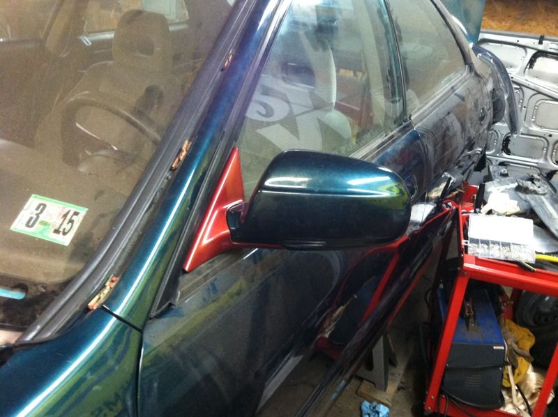

my mis-matched mirrors

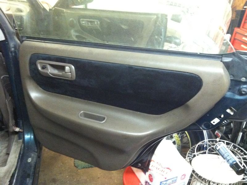

pics of my re-installed my door panels, oooooh custom.
ignore the wiring mess. i'm still sorting this out and chasing bad wires.
after installing the door panels, i also found out that my rear window motors are completely dead. as far as i know, they have never been replaced so they are 20 years old. so are the fronts. the fronts work so-so. but i can't get the rears to move. so by the time this is back on the road, i shouldnt need to worry about getting the rear windows down this year, but this is something else that will get added to my winter to-do list.

I have an extra set of cgp mirrors you can have if you need them. They are off a sedan that i was hoping would work on my coupe but didn't. They are 96+. One of the mirrors have cracked glass on them but if you want i can send you just the bases.
drmix is offline
post #441 of 715 (permalink) Old 08-15-2016, 12:57 PM Thread Starter
danteisme's Avatar
Join Date: Jul 2003
Location: South Western PA
Posts: 2,558
which mirror is cracked? i plan on respraying the whole car hopefully 2017 so the mis matched bases dont bother me. BUT, i may want those mirrors anyways for extra parts

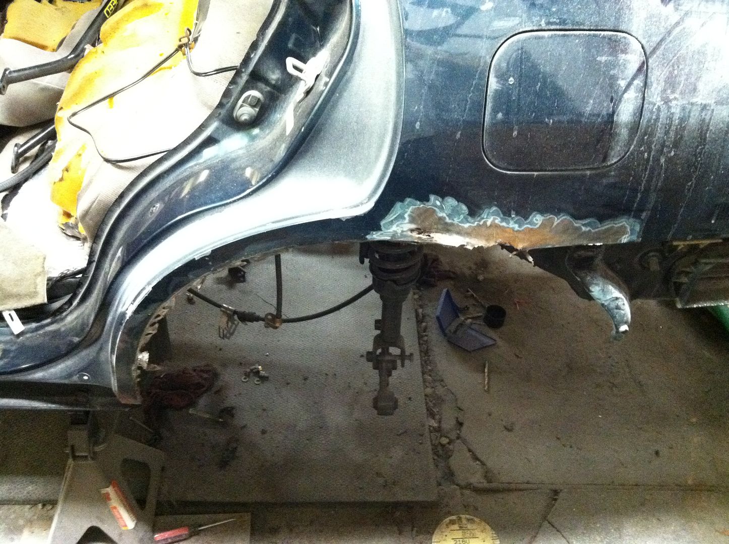

unfortunately, i have a bunch of no good updates...i had to re-focus my work on the car. *Well, maybe one good update. the passenger side outer panel is going to work fine despite my original freakout. I remember now why I was skeptical of the driver's side quarter panel i got. *I took a closer look of it over the weekend, and it is junk. *Complete junk.... *i really don't think i can use any of it. *Which really, REALLY throws of this car's schedule... *i knew it was bad, but i didnt realize how bad until i started grinding. as soon as the grinder hit it and worked through the paint, it instantly started throwing white dust around. *its all body filler, it has been repaired once..and not well at that. *I kept grinding through the wheel arch area to find some spot welds, and its all junk. *Because of how it was repaired, its all rusted out. *It was repaired with booger welds and some weird glue. *it could be panel adhesive that no one bothered to finish. *It's not much better than the one on my car now to tell you the truth. *I'm really bummed out about this.
looks good from far, see all that white? *Body filler.
There is a spot weld under here somewhere
there should be a bumper mounting tab here
JUNK

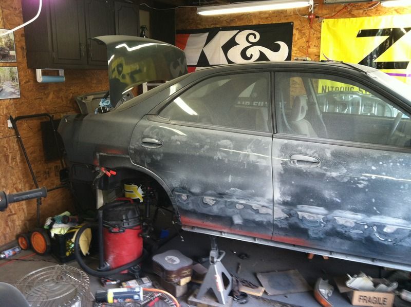

so like i said, i had to refocus my work for the weekend... *i shaved off the front bumper license plate mounts and filled those in. *i also sanded the bumper repair to get ready for the flexible body filler
installed my replica lip. *not a huge fan of how it mounts, but i can make some additional mounts for it.
wiper cowl installed.
short strand body filler applied to where the side mouldings used to be.
after it hardened and was all sanded down, i applied a thin bit of standard body filler to smooth it out. *still have to sand this out.

i'm working with a member on honda-tech right now that is nearby a salvage yard out on the west coast. he is getting me a quarter panel for my driver's side repairs and will ship it to me. super helpful guy.
while i'm waiting on that piece, i will finish up work with the ecu wiring(which is turning into a complete nightmare) re-assembling the rear suspension, and installing the gas tank etc... hopefully when that is all finished i'll have the new to me quarter panel on hand and that should be the last piece of the puzzle.
i'm sure once i actually go to fire this up, i will have to start a new list of things to be done. quick couple pics for now:
the reason i need a driver's panel...
