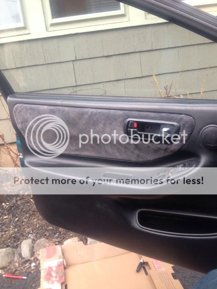

For those of you who have good eyes..in the interior shot of my above post, the left door panel does have the extra speaker on the top half of the panel, while the right doesnt. My ls had a hole in the left door panel. So I picked up a new one for 20 bucks. Of course, me being dumb, I actually picked up a 2000 GSR panel, which had the extra speaker and was all black leather as well. I could not stand the two door panels mis matching. So I removed the trim (I guess you could call it that) by just peeling both of them off. I was careful with the cloth from my original panel. I used a hot glue gun to carefully glue back the cloth onto the new GSR panel. I think it came out decent!

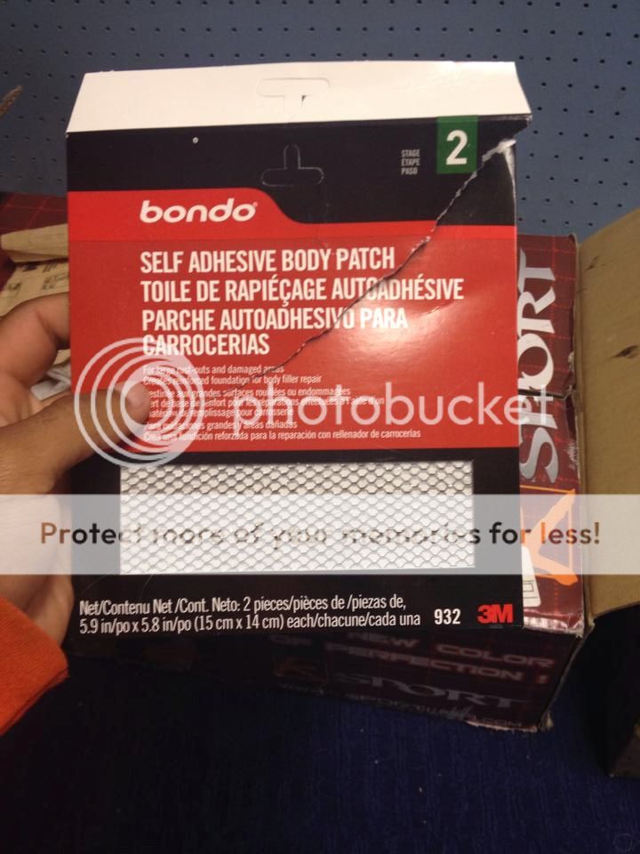

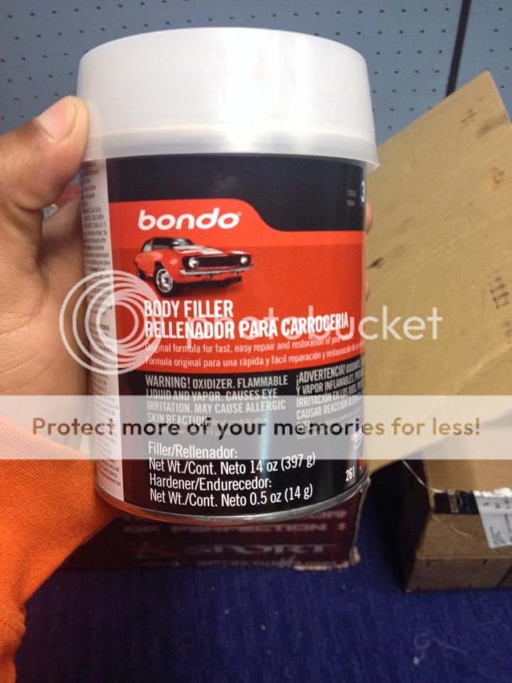

Temp Rust Fix (Tips, tricks?)
So now that winters over, I decided to attack this rust. My goal is to just make it look decent. I'll get around to fixing it for real. I cant drop a G on body work right now.
Will need:
Body filler (bondo) $20
(usually comes with hardener, youll need this)
adhesive body patch (bondo) $10
touch up paint and clear coat (parts bin) $10
sand paper..i already had this
possible a paint gun (not sure yet)
touch up brush
Dont forget the hardener!
Plans are:
Grind (done)
Cut body patch to replace rusted out area
Fill with bondo
Sand
sand
sand
paint
clear coat
pray
Really hoping this comes out good. If anyone has any tips or tricks let me know

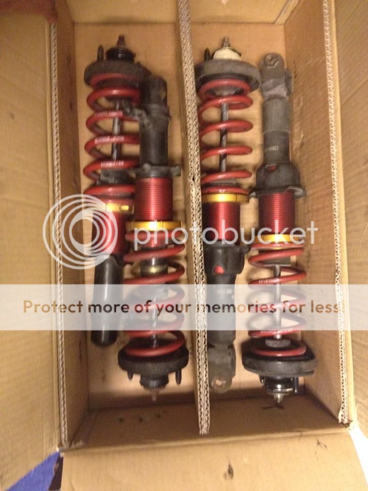

So I picked up some Ground control coilovers a couple weeks ago for a VERY low price. They're on OEM EG struts (lol) I'm actually looking to buy some Skunk2 Shocks to go along with them- they're affordable and are shortened, and knowing Skunk2's springs they should be very durable- the OTS GC's don't even have very stiff springs. If anyone has experience in this setup let me know how they ride.
I was actually about the sell these to a user on here named Fred, a very nice, understanding guy- I changed my mind last minute due to some changes in a deal I was supposed to get and I canceled the sale. He was very understanding. Thanks Fred!
So yeah, just waiting for some shocks & wheels (looking for ls webs) until these go on.

Now that your done grinding... you have any pics ?
If done right the passenger side quarters should have a HUGE chunk taken out (more than that body patch is going to want to take care of .
You should pop rivet some sheet metal in there
Anyway good luck with that , how's it been going
I took a little rust off my quarters on my last integra but it was only dime sized , after I was done grinding it all away it was the size of a dollar so I can't even begin to imagine your situation
Just make sure you bond enough over where the missing body meets the metal and then as you said above sand sand sand , I assume you have the proper grits picked out (definitely not a one day project in front of you)
Have you had the springs off of those shocks ? (To check if their blown) if not you maybe able to use them for a very little while
Lca bolt + anti sieze= WIN
I see your in the city , not to far from me in pa
I just sold my webs with tires for 75 ...shit
What part of the city are you from
Hey! Actually those pics of the rust had a LOT of rust taken out completely already...i'd say both sides are 30-50% larger than they first were. I could definitely go more, you're totally right- but I'm just doing a temp fix to last a year or so until I get money to have a body shop do it to completely eliminate my rust problem. That's the plan for now.
About the shocks- I'm almost positive the back two are blown, and I'm about to take them off now actually! I really don't want to have to swap my shocks more than once though, so I'm avoiding riding on stock shocks.

Hey! Question: I'm having trouble getting my GC Coils off the stock struts..any ideas? I tried soaking in WD40. I might have even stripped the allen wrench socket.. ):
Damn.
You want to lose the nut with an open end wrench not the Allen screw
Look at this thread at what their doing when taking the top hat off
G3 Coilover/Shocks/Springs Install - Team Integra Forums - Team Integra
