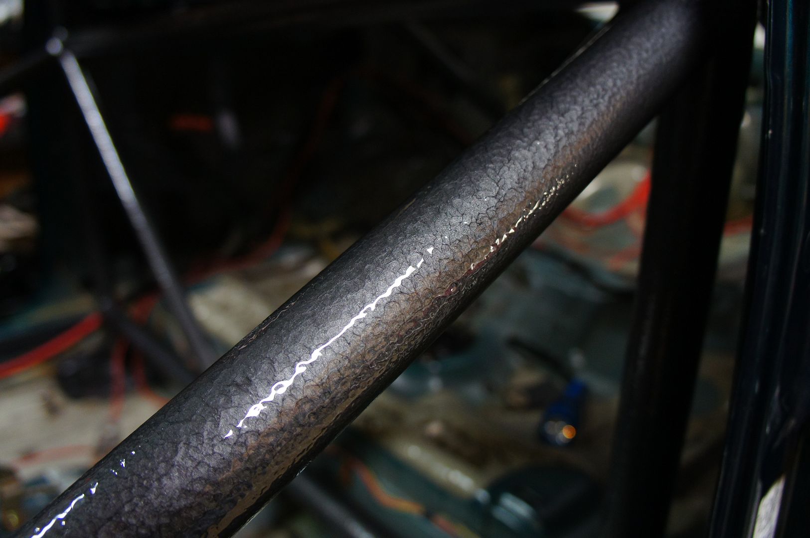

Same exact stuff i used... it's awesome... easy to apply, looks good, works great
I used a foam paint brush btw, worked better than a bristle brush
I bought a small foam roller and a small bristle brush for those tough spots. Guess ill see how well it works.

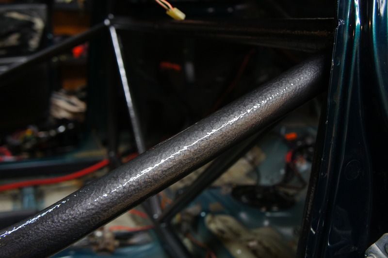

Roll cage is painted! I ended up just using the brush to cake it on. The heavier the layer of the paint the more hammered effect it gave it. I love the look of it I just wish it was a little darker but I am still really happy with it.

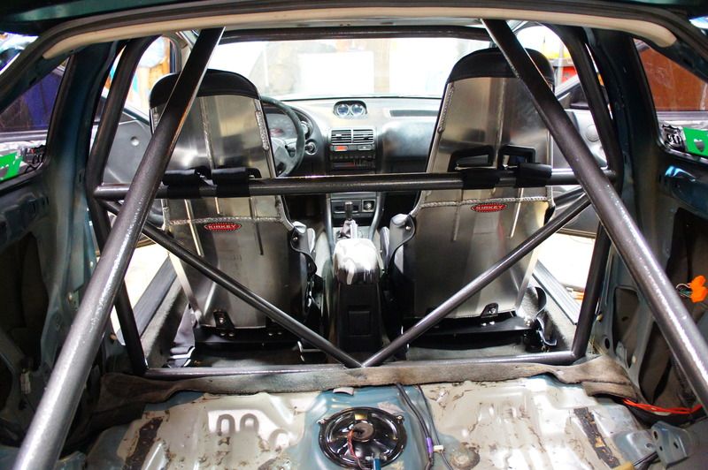

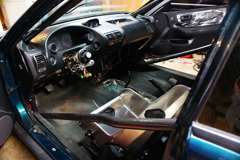

Spent some time on the teg last night. Went to start putting the heater motor back in and it does not fit anymore with the bar in place. Ended up just removing the heater core and ditching all that completely. Plenty of room under the dash now and even more weight taken from the car.
I was planning on working on it more today but ended up waking up with a scratchy throat and feel exhausted. Just my luck to get sick on a 3 day weekend lol.Im hoping to get out there tomorrow if not Monday and finishing it up.
What is left:

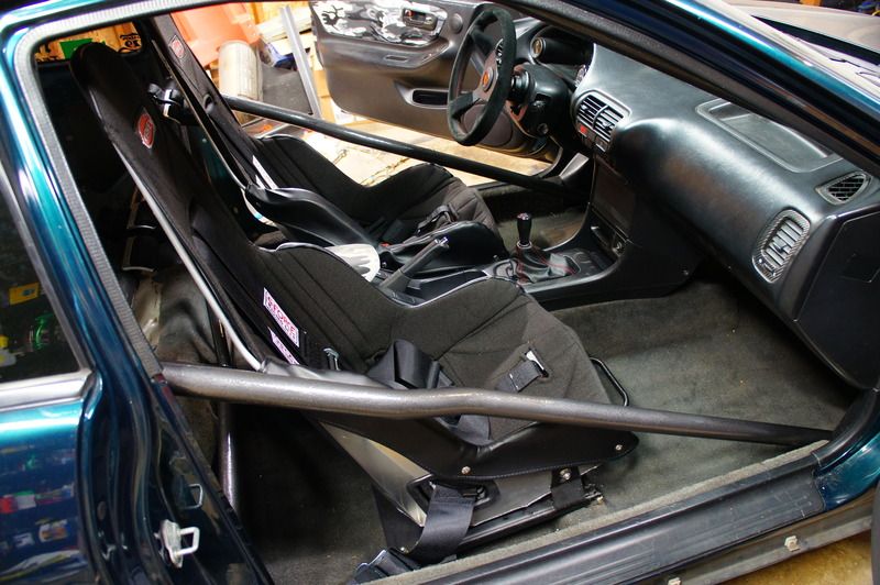

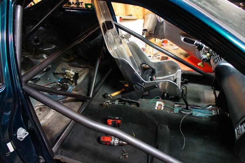

*Mount passenger seat to the rails. Drivers is already done.
*Install harnesses
*Cut and trim dash to fit
*Install carpet

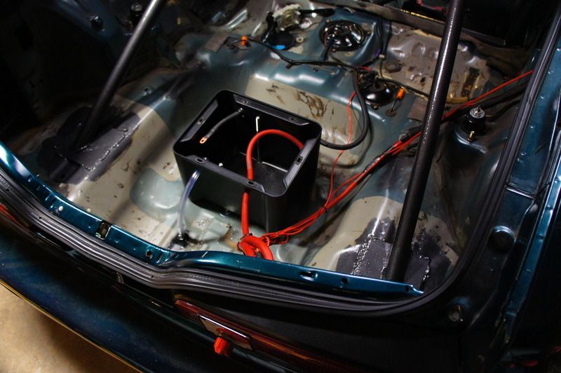

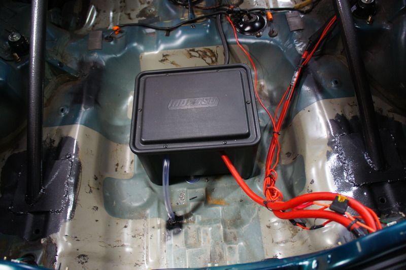

*Remount battery in new location since the bars in the rear landed where the battery use to be

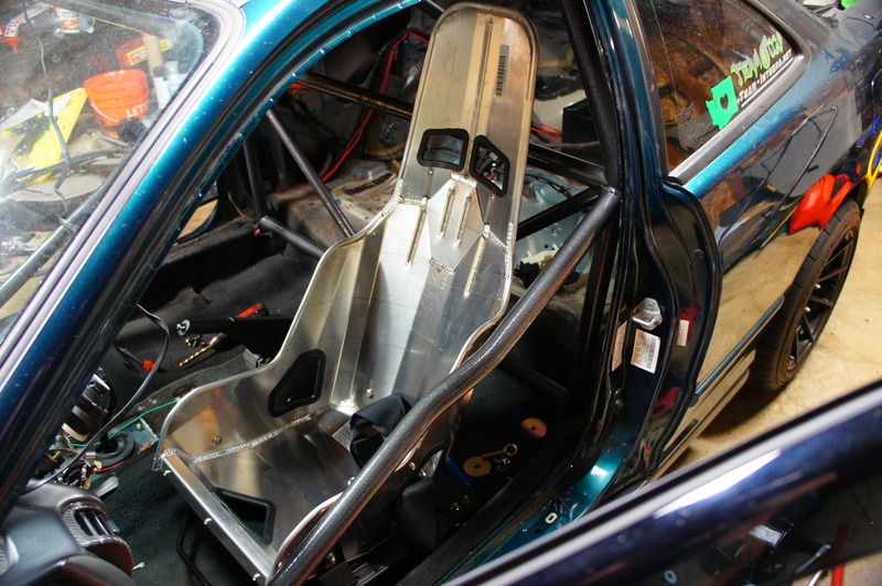

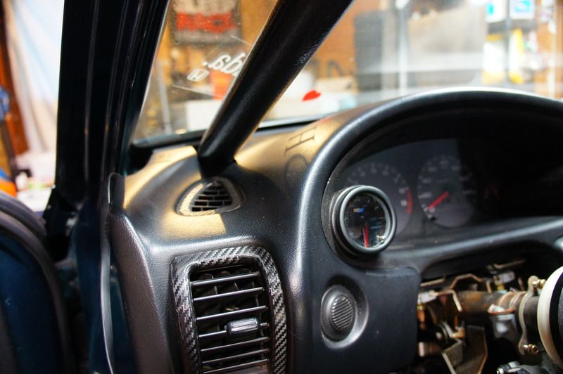

I was able to get the passenger seat mounted to the rails so both seats are ready to bolt in. Spent some time last night hollowing out the dash and removing the vent ducts since those will not be used anymore. It will make it super easy for running wiring through the dash since its wide open now. I still have the trimming on the dash left to do since I have been putting that off until the very end but its just about that time. I hacked up my old tan dash to help with measurements for where the bars pass through the dash so that will help. I have pics that I will be posting later on.

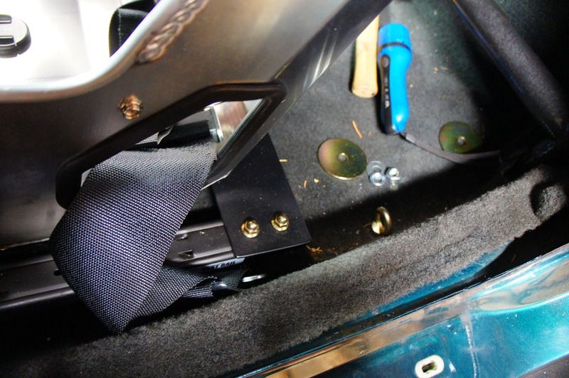

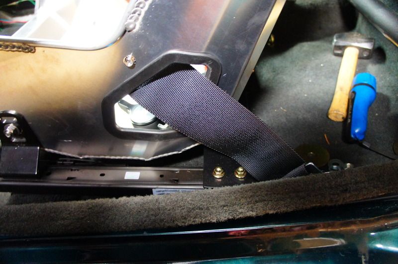

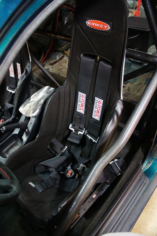

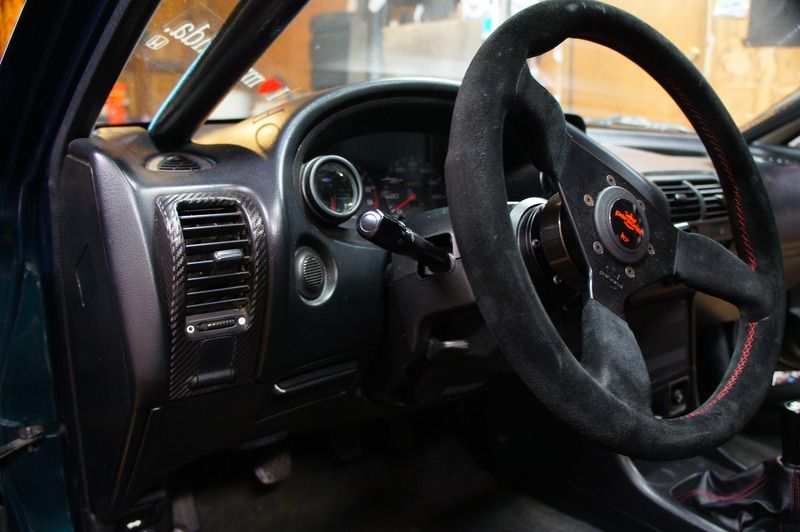

Spent some time on the teg today. Dash is in and gauges are wired up. I started working on installing the eye bolts for the drivers side. The left eye bolt is in but the right one will need a longer bolt. I thought 1 7/8" would be plenty long enough but I guess not for the center of the car where the frame is. I will be looking for some longer ones during the week while I am out of town. I am hoping to finish up next weekend now that the hard stuff is done.
Im surprised how well I trimmed the dash to fit the bars. Looks alot better than I thought it would
Battery had to be relocated since the bars took up the corner of the hatch where the battery use to sit.

I just did like 10 mins of searching, everything i found is that 1 and 7/8" length
I had absolutely no such problems with my bolts on the floor, in fact they were too long (scraped on the trailer when pulling the car on and off), i wonder what's different
I didn't take any pictures of the passenger side unfortunately, but they are in the same exact spot as the driver side here (i put three on each side so i could use 5 or 6 point lower belts)

Yeah the left lap belt has plenty of extra thread on it. I will probably cut it down so it doesnt get caught up on the trailer.
As for the mounting of the belts mine are going much farther back then yours are on the floor.I am a few inches behind the rear mounts for the seats and when it comes out of the floor it is on the opposite side of the fuel/rear brake lines. I am guessing that this part of the car is reinforced to protect those while bottoming the car out.
NHRA calls for the lap belts to be sitting at 45 degrees when sitting in the car which is why the are so far back. I also had to move them back slightly so the belts wouldnt rub against the seat rails.
Well good news though. I went out there and looked it over, gave the eye bolts a good couple whacks with the hammer and all is good. I guess when I drilled out the floor it was on one of the bumps in the floor so when I hit it with the hammer it brought it down enough to work.

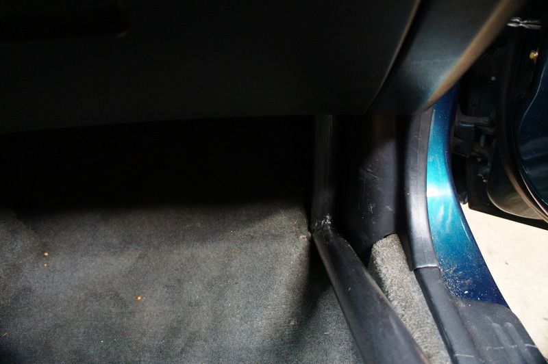

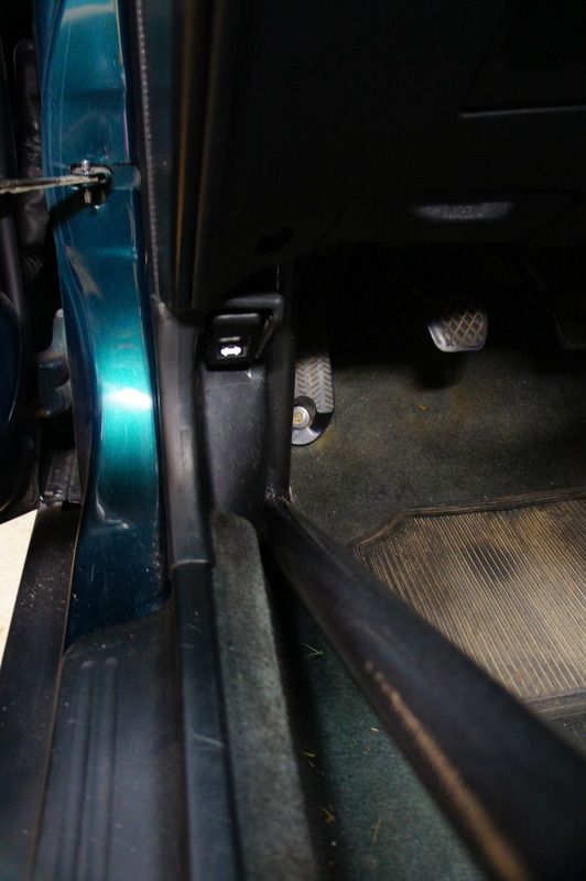

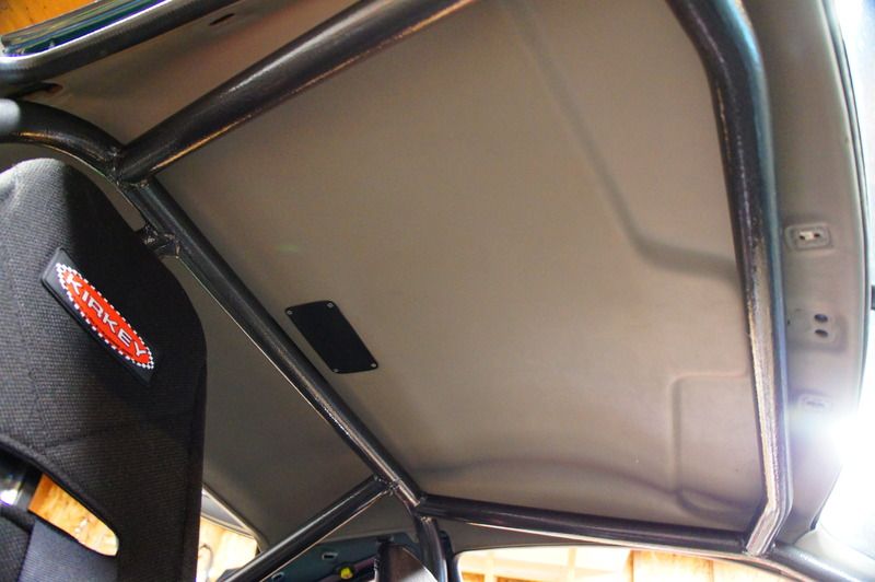

Put in some time this weekend and got the car all finished up. Surprisingly both kick panels fit with some minor trimming and force. Headliner slipped right in with some assistance. I am loving the fitment of everything so far. The door panels do press against the door bars slightly but its nothing too bad.
Couple things left to work on is I will be putting a couple bolts in the headliner since the stock relies on handles, visors, and other stuff to secure it so its just kind of hanging now. Still need to put in the floor mats and give the car a good detail before the Drive NW event on Saturday. I am planning on going to the test and tune on Friday mostly just to make sure that tech is all happy with the new car setup. I would hate to wait until the event on Saturday to find out that I cant run because of something I could have fixed Friday night.
