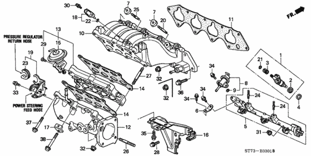

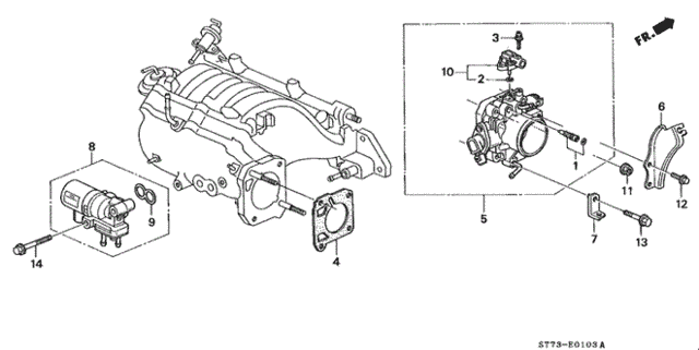

You have a Short Ram Intake not a Cold Air Intake. Cold Air Intake your pulling in cold air outside of the engine bay. Short Ram Intake your pulling hot air (motor heat).
I have a feeling you are referring to the big silver thing that set behind the engine and connect to the throttle body with (4) runners. That is called a Intake Manifold. The more I read your post. I won't be surprise that the timing is off.
On your vehicle you have (2) butterflies Valve for Primary and Secondary. Something to check in that area.
Intake Manifold Diagram

The popping noise inside intake manifold (large silver part that resembles "4 fingers") is unusual. The popping noise usually relates to engine backfire and is amplified by the muffler. If you have a popping noise inside the intake manifold (IM) and the car has lost the power, perhaps you experience a mechanical failure inside it. As patintegra said earlier, there are so called butterflies inside the IM. These are 4 metal plates that control the air flow, which you can't see unless you take the IM apart. I personally never heard of such problem, but parts do fail. I agree with patintegra that the sound you are trying to describe maybe related to the timing belt's incorrect position. When set correctly, the timing belt synchronizes fuel, air and spark delivery in relation to piston and valve position. If the timing is off by 1 tooth, you maybe experience early spark delivery, also known as pre-ignition. This would produce a sound you may be hearing. But before you begin verifying the timing belt position, If you haven't done so recently, consider replacing the following:
