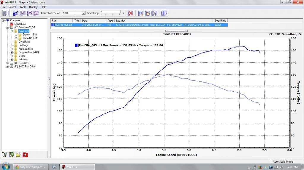

I'll add mine to get this topic (re)-started
99 Integra GSR B18C1
- CP forged pistons
- shot peened rods
- Balanced and blueprinted block
- Stock valve train with dual springs added on exhaust side
- ITR camshafts
- Jackson Racing supercharger running @ 10 lbs boost (CRV crank pulley + smaller pulley on JRSC)
- SMSP header, magnaflow exhaust
- Devils Own methanol injection kit
- Tuned on eCTune by John at phearable.net
Maybe could be a bit higher #'s wise, but I'm happy with my build as power delivery is smooth and predictable, making it great on road courses....

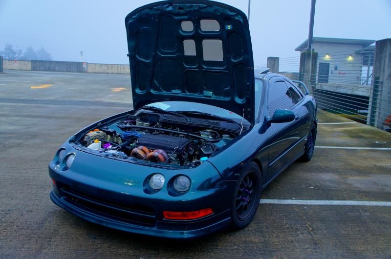

I need to update as well:
My current setup is as follows.
-84MM Benson Sleeved B18B1.
-Stock LS crank
-ARP Head studs
-Eagle Rods
-CP Pistons, 9.7:1
-GE 84mm / OEM headgasket
-PR4 head, factory ports
-Crower 62404 N/A cams
-Crower Springs and TI retainers
-Victor X Intake
-Greddy Type RS BOV
-2.5 Mild steel charge piping
-Treadstone TR8 Intercooler
-Five 'oh Motorsports 1400cc Injectors
-Walbro 400 E85 Version
-GoAutoworks T3 Ramhorn
-Tial 38mm Wastegate
-STC Reaper 62mm. Was an SC61 that was uprgraded with reaper wheel and garrett parts
-Full 3" Exhaust
-Mishimoto X Line Civic size radiator.
-Koni Yellows / Ground control (380/400)
-Omni Power 23mm Rear sway bar
-Polyurthane bushings front lower control arms
-Full race traction bars
-F: 15x8 235/50/15 R888s on Rota Slips
-R: 16x7 205/45/16 Nitto Neogens
-GSR gearset with LS final
-Speed factory SCHA
-Rebuilt 2 years ago new synchros, had gearset micropolished
-Tuned on eCtune by myself
-Boost by gear
-1st and 2nd 15lbs,
-3rd 25-27lbs
-4th and 5th 30lbs

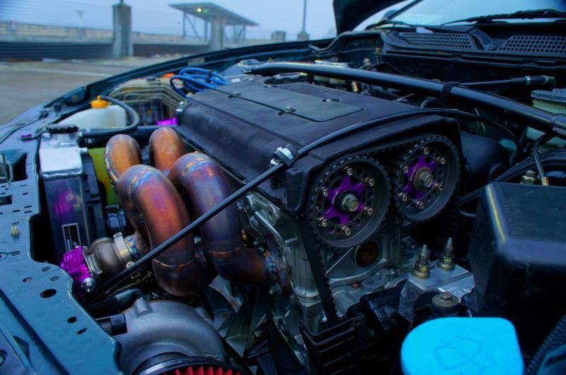

98 JDM Type R B18C
Engine Setup
-82mm Wiseco 8.7:1 pistons
-Stock sleeves
-Precision 5531 turbo
-Vibrant intercooler
-BWR ramhorn manifold
-Tial 38mm MV-S wastegate
-Tial Q 50mm BOV
-Victor x intake manifold ported to match TB
-Skunk2 70mm throttle body
-CTR cams
-Supertech flat faced valves,springs and retainers
-3in exhaust and downpipe (no cat)
-RC 750cc Saturated injectors
-Hondata S300 V3
-Omni 4 Bar
-92 Premium fuel

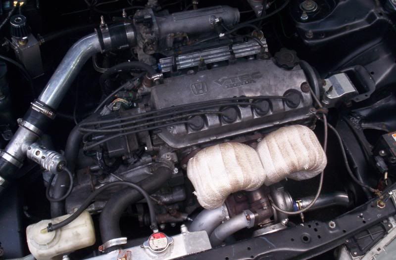

so i actually dont have any of these in my car currently, but im already logged onto photobucket so i might as well post.

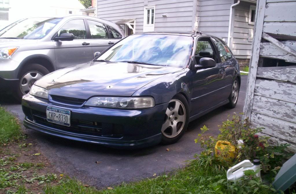

jdm itr front on an eg hatch.

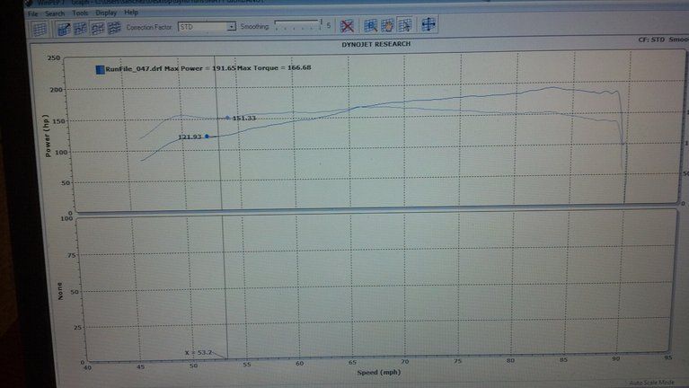

vitaras and eagles in a z6. stock head, 2.5" exhaust, lovefab ramhorn and a 15t from a saab viggen. this was on 9 psi. had it up to 14 but the internal gate wasnt holding till redline. it made 240 ftlbs on that 14 psi, ran 13.8'[email protected] on radials on like 16-18 psi boost.

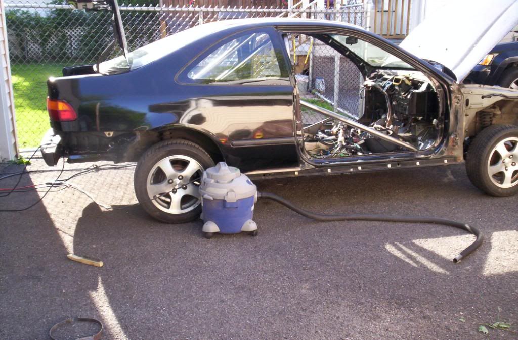

started life as an automatic. i ripped it apart, welded in the cage, and put it all back together from the ground up

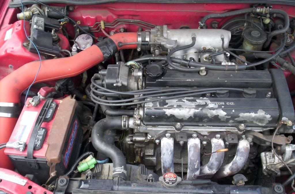

a bit older engine bay pic
84.5x89mm gsr block with b16 head. victor x, ctr cams, cp's and eagles right at 10:1. its a benson sleeved block. peakboost ramhorn, t3/t4 60-1, 3" turboback, comp st5 clutch yada yada yada. i still have this motor, its apart getting a new hone, rings, retainers and bearings. this is 16 psi boost using c12. i tuned it up to 16 psi on 93 pump, made 438/286. went consistent [email protected] with a 1.75 60ft. could go 10's, just need maybe 2-4 more psi and some seat time. track days stretch my funds pretty thin so i dont go often.
