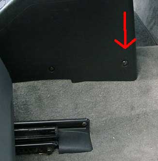

Slide both seats all the way forward, and remove these screws on each side.
(The screw to the left you do not have to remove)

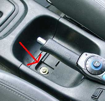

Pry up the cover under the parking brake (you'll see a small slot of the left of it), and remove these two screws

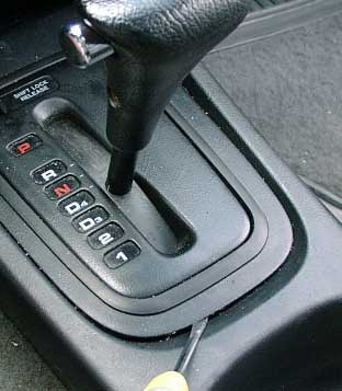

Gently pry at the surrounding panel of the shifter, this piece, which goes forward to just about under thr ashtray, lifts stright up

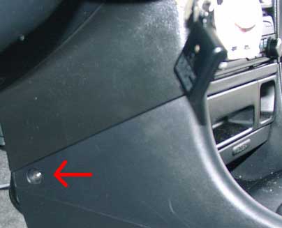

Remove this front screw from each side of the console

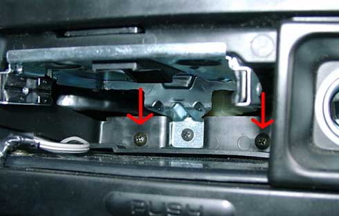

Take out the Ash Tray, remove these two screws (the middle one can stay)

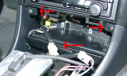

Pull out the assembly by pulling straight back, take out these two screws and unplug the plug feeding the lighter with power

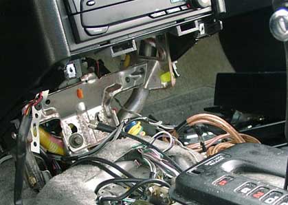

Pull the entire lower console straight back and then up and around the shifter, and look at all the room!! The two screws holding the factory radio assembly are two silver 8mm facing straight down towards the back of this cavity
Also note that the Storage Pocket of the factory radio is attached to the radio, once you take out the two 8mm bolts (shown in next step) the radio and pocket will come out

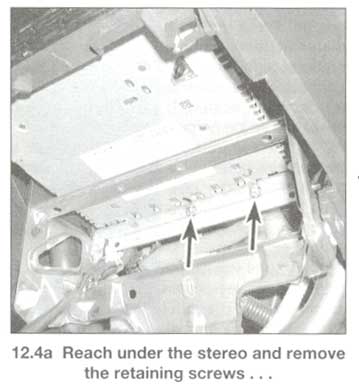

Two screws holding in the factory screws are here (picture from Haynes manual)
Using an 8mm socket, 1/4" Ratchet, and 6" extension, these are easily accessible
