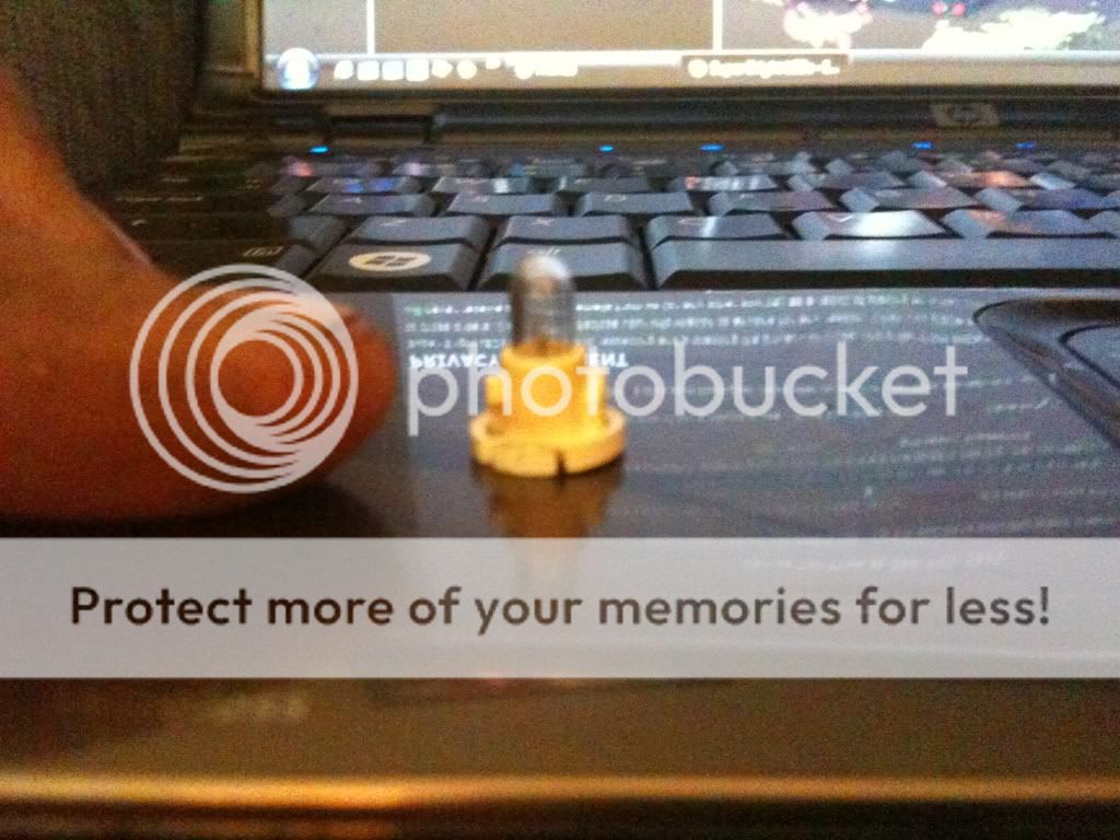

Okay, so ive seen 5 bagillion "which bulbs do I need for my climate control threads", mostly old, but never updated.
This is what you have
If you want to upgrade to LEDs, here is what you will need
Super Bright LEDs - Instrument Cluster and Gauge Backlights
You the want 4(four) 4mm NeoWedge Series bulbs for the climate control.
For the Hazard and Defroster bulbs, you are going to want to get 2(two) 3mm NeoWedge Bulbs
Intensity wise, its up to you. I just orded mine a few days ago so once i get them in I will be sure to post up pictures.
*This is based off of Super Bright LEDs categorizing of NEO bulbs. They may be different from other LED suppliers*

Gotcha guys, I edited the first post. And my mistake, I jumped the gun on the 5 mm bulbs they are really 4 mm. (I bought 3mm then 5mm and realized that they are actually 4mm)
And correct me if Im wrong but it looks like the hazard and defrost buttons are 3mm. Any comments on that?
