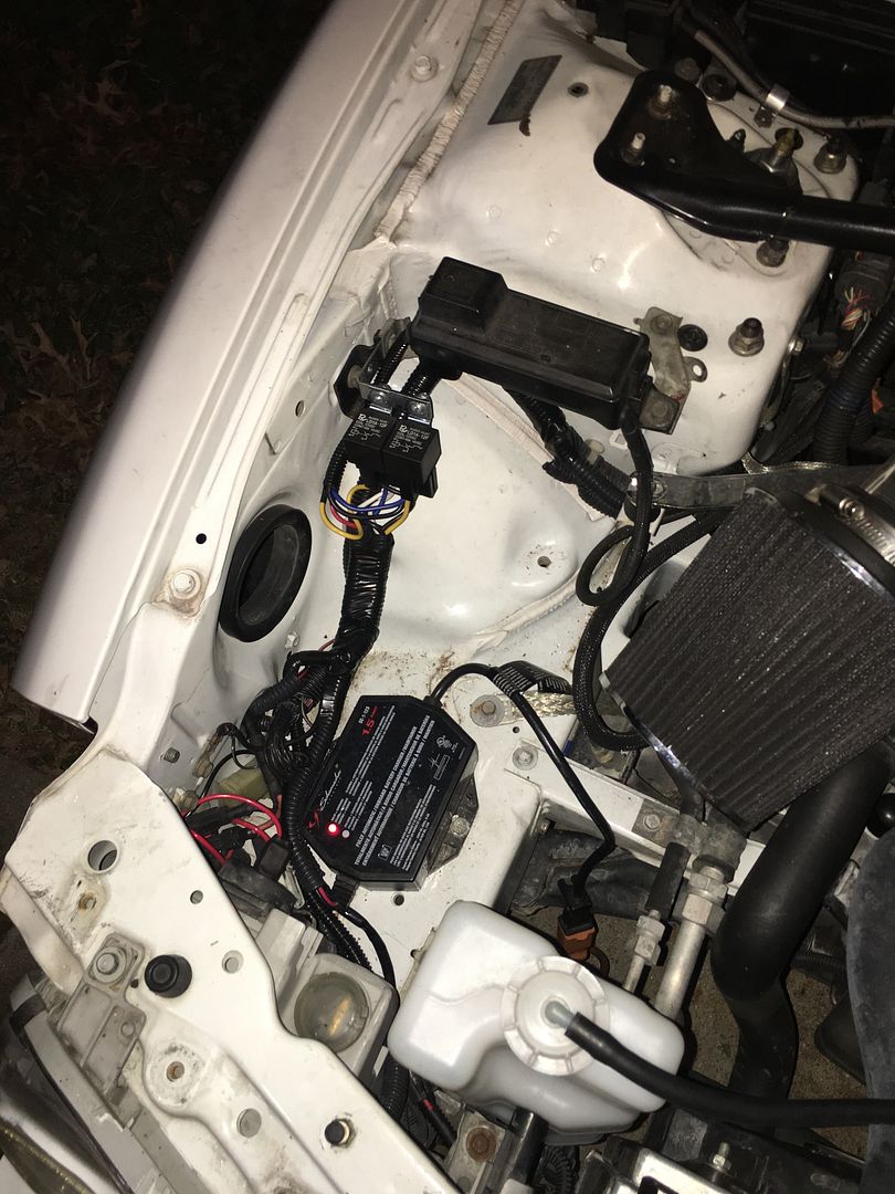

Last few days, finally tackled something that's been on my list.
  • Replaced my dying factory horn with a pair of Wolo Loud One Horns (both High and Low Tone)... https://amzn.com/B000BRFGGA ... The pair are obnoxious compared to the factory horn. Either tone horn on its own would have been a substantial upgrade over stock.
  • Added in a OEM fog light switch to the center console
  • Cut off and capped the wires that used to run to the ABS fuse box / pump
  • Re-purposed the ABS fuse block for some accessory power (new relay for horns, new relay for accessory lights, tied in the battery charger)
  • Re-loomed everything in the area where the ABS pump used to be
Sometime in the coming weeks, I'll be getting the car up to a friend of mines shop, where we'll be tacking the exhaust into place. I got a 2.5" stainless Cat-back setup, that's all slip-fit with band clamps, and a couple of the joints keep slipping, which ends up causing the muffler to rub against the trailer hitch (it'll hold for 500 - 1000 miles, and the vibrations come back). I've tried like hell to hold it still, and can't. We're going to snug everything back up, re-work a hanger or two, and then put a tack or two on each of the joints to help hold them in place.
Pics from this weeks adventures, will update again once I have it in the air and the exhaust fixed.
"Before", the ABS plugs were bugging me
"During", just about buttoned up
"After"
New Horns, mounted on the bottom of the center radiator support
Wire loomed and tucked away
