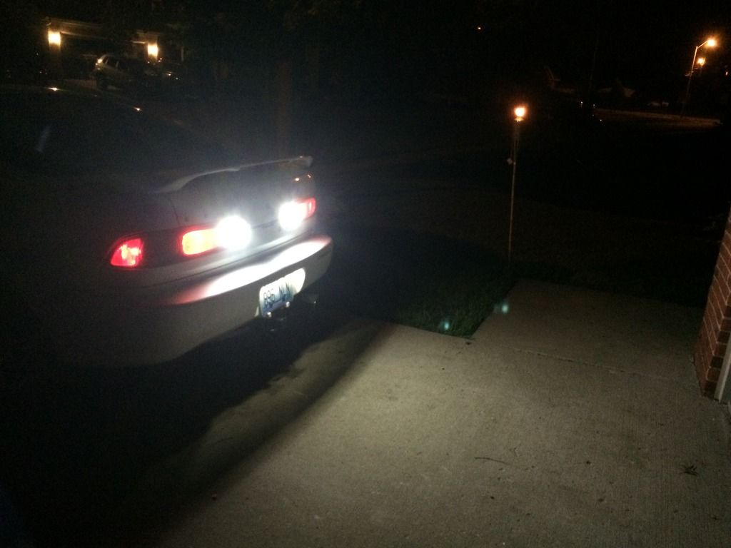

Here's a few pics of the bulbs themselves, along with a few different shots of the output. Again, really hard to capture, atleast with a camera phone.
No lights (during daytime)
Reverse lights (during daytime)
Video of me backing up (and showing the strobe flash I put on the spoiler)
Parking lights (no brake lights are on)
Reverse lights

damn those things look pretty bright!

Wow! Those are bright
