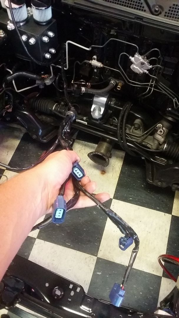

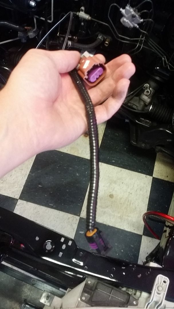

Wiring Harness:
Some additional items have been addressed. First, is the Coil On Pack - Hondata harness. This was pulled through the firewall.
This harness was created for the additional sensors. Wires for the boost solenoid (not shown), flex-fuel sensor, and fuel pressure were run, along with appropriate connectors. All of which can be datalogged.

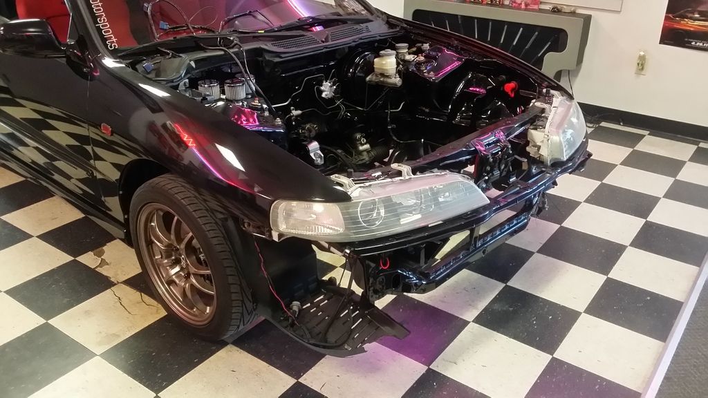

Update:
Cylinder head is currently at the 1st of two machine shops. The first will be o-ringing around the combustion chambers, and the 2nd machine shop will be re-seating, and installing the BC valves.
How the car currently sits:

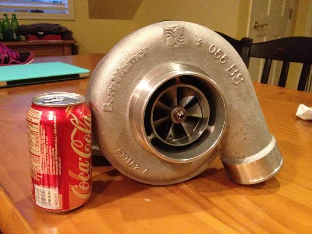

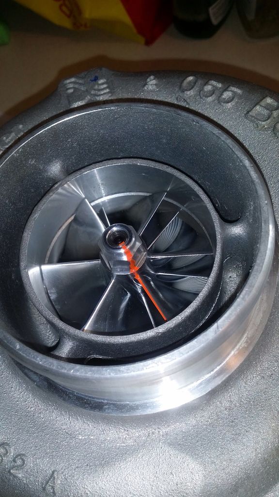

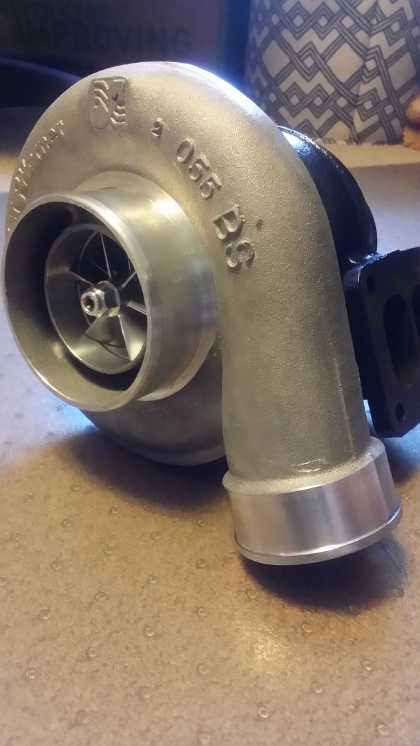

Turbo:
Got the turbo back today. I had a 6-blade split billet wheel installed, and had it balanced. This compressor wheel looks like a piece of art.
Before I sent it out:
And what it looks like now with the new wheel:
Taking this to the shop, probably tomorrow. Thinking about shooting the compressor housing with silver Duplicolor, the same paint as I used on the engine block.

Turbo looks awesome!
I think youll need the flame proof paint for the turbo. Im sure the normal engine enamel wont last long on a turbo. I would personally go with a black but thats just me.
I have the hot side ceramic coated in black, and thought that maybe it'd be too much black. I've been tossing the idea of doing something different as well. I've had this idea of copper plating the compressor housing, along with the valve cover, with black lettering. I don't see copper motifs used too much.

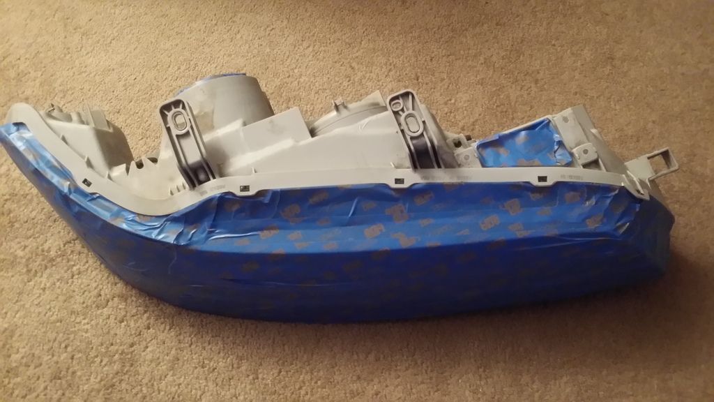

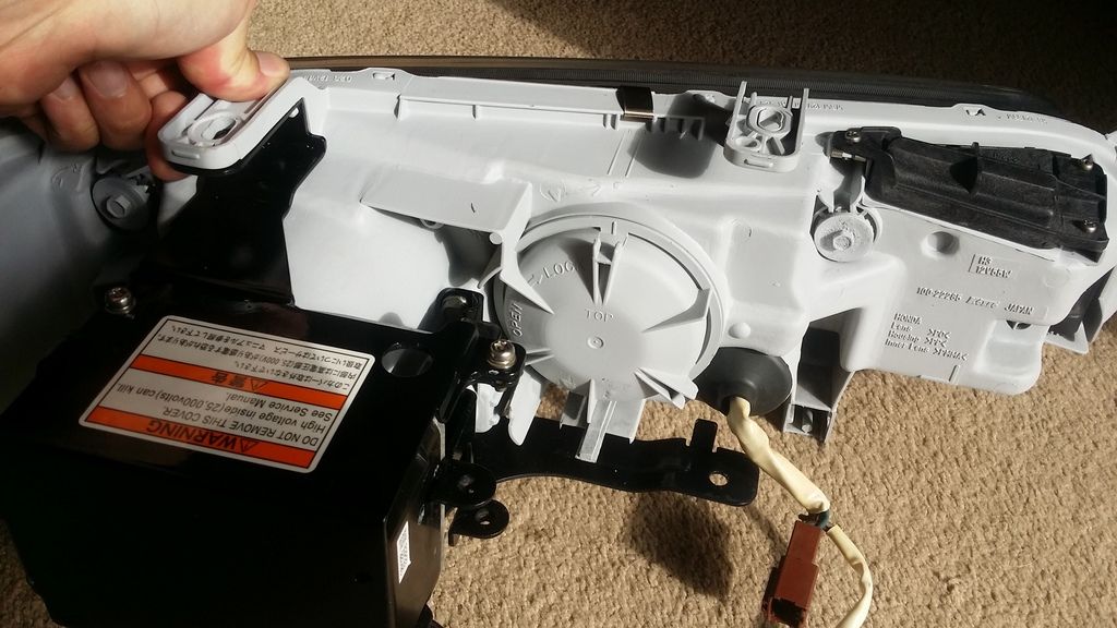

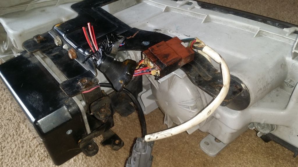

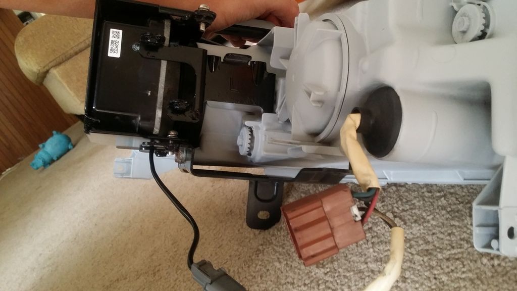

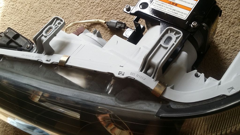

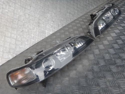

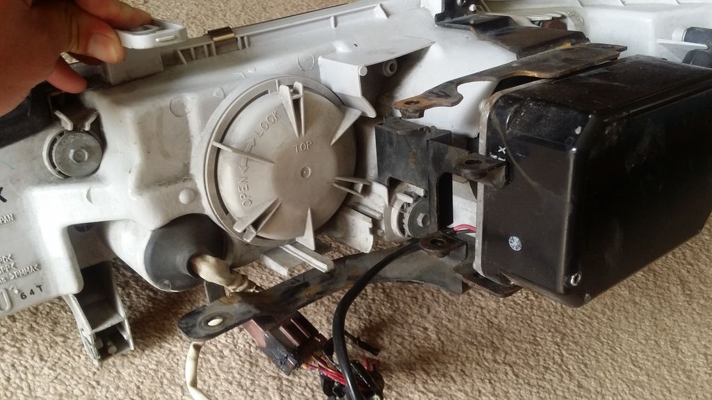

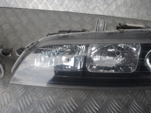

Got the new headlights in. And, although the lenses are clear and perfect, the rest of the housings needed some much TLC. Here are some pics showing the grease, rust, and overall condition of the headlights:

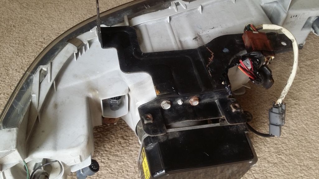

As you can see, these were harsh to look at when I got them. Again, the lenses were clear, non-cloudy or hazed, and in perfect condition. The rest of the light needed some love, however.
So, lets do something about that, shall we?

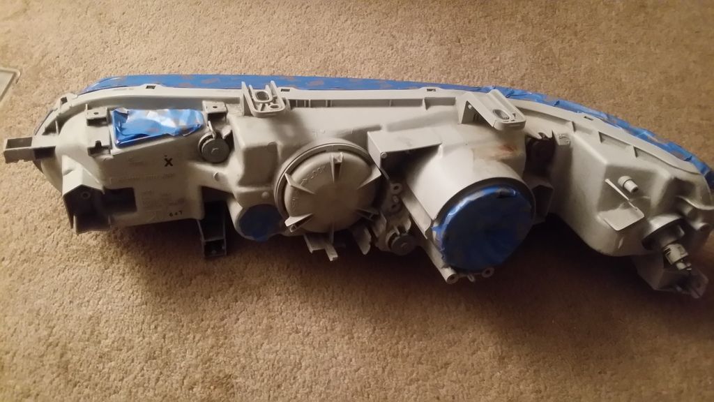

First, I completely dismantled the headlight housing, pulling the internal wiring harness out, and dismantling the attached ballast, and all brackets. Then, I degreased as much as I could, and taped off everything but the back of the lens:
I found that the perfect matched paint for the back of the housing, is standard grey primer. And that's exactly what I used to spray the back of these (I unfortunately didn't get a picture showing the paint after spraying, instead, I have pics of the finished product).

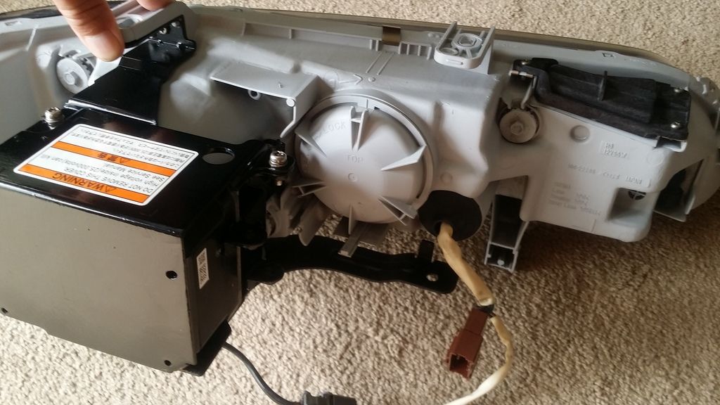

I then purchased new Honda OEM warning labels (2) that typically are attached to the top of the HID ballast bracket. Ordered these from ICBMotorsport.com
Dismantling the wire harness proved to be a pain, but wanted these to be in "like new" condition.
I sprayed all brackets with 4 coats of a base black, attached the labels, and sprayed 5 coats of clear over the brackets and labels. I wanted these to be protected, and not peel from engine bay heat.
Here's the final product. I think both headlights turned out great.
