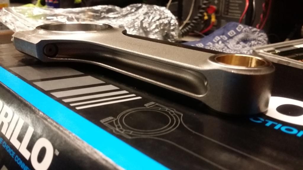

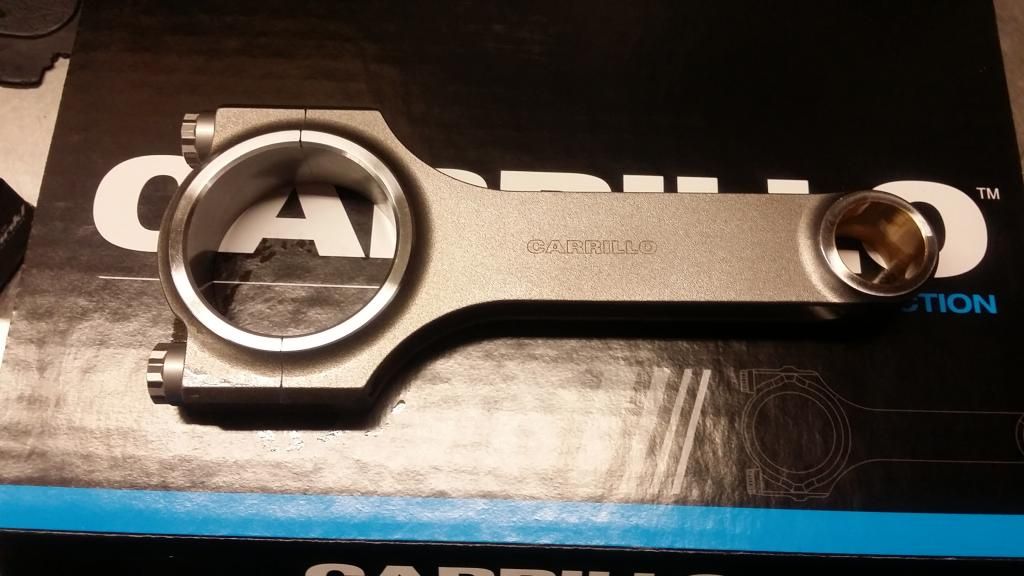

Connecting Rods:
I decided to go with Carrilo's. They're top of the line rod for Honda's are their Pro series, which I splurged on. These aren't your typical H-beam rod. These aren't your typical H-beam rods that are tapered. Using a straight h-beam, (not tapered) they're some of the strongest rods available. Additionally, these come with 3/8" rod bolts. They're huge. These things are meaty, beefy, and pictures do not do these any justice. They were also salty, at $1100.

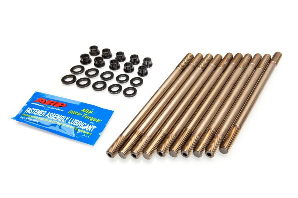

Head Studs
As guessed, I'm utilizing ARP studs. However, I'm utilizing their L19 line of studs. L19 differs from their standard studs that they're vacuum melted alloyed steel with sufficient chromium and carbon to achieve high hardness. These have strengths that have been tested at 270,000 psi. These also had a hefty price tag.

the L19's seem to be about 2x the price, that right?
@MorningZ Ugh...they are. These ran me $400. But, they're worth it, IMO.

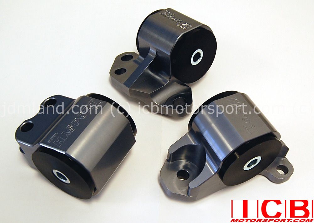

Engine Mounts
Believe it or not, up until now, I've been utilizing the factory stock OEM engine mounts with 84K on them. They haven't let me down at all, and have kept vibrations at an OEM level. Because of my new goals, I think it's time to upgrade. I ordered up a set of grey-anodized HASport mounts. I got their "street" version. I don't think I need anything extremely solid such as their "race" versions. I'm still waiting for these to be shipped, which I'm hoping is this week. HASport was in the process of manufacturing these, since I ordered them with the grey-anodized finish.

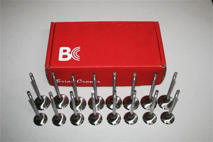

Valves
When I built the motor the first time, I kept the stock valves, as they were fine for my power goals. I decided that these need to be upgraded, as they're cheap enough to ease my mind. I ordered and received a set of intake and exhaust Brian Crower stainless steel valves. I kept them a standard size.
