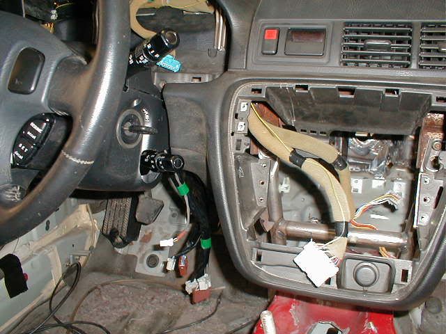

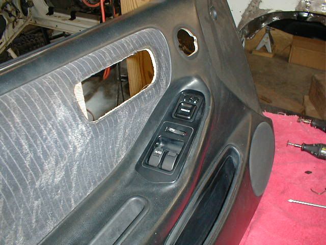

I’ve been working on the wiring while the gas tank cover and rear floor are being made. Since the Prelude has no provisions for a rear wiper, I used the switch and harnesses from the Teg and added them to the Prelude. These shots show the Teg wiper switch mounted to the Prelude column, just below and ahead of the ignition switch. The harness and connector hanging from the center of the dash is for the stereo system. You can see where I added a wire from the Teg for the power antenna. Fortunately there was one unused pin in one of the two connectors between the dash and main wire harnesses.
The Prelude has what they call a “Multiplex Control System”, which consists of three control units that talk to each other via serial communications. one of the units is incorporated into the driver’s power window switch, which meant replacing the Teg switch. I was hoping to just bolt-swap the switches, but unfortunately they were not compatible, so I had to modify the switch mounting from the Prelude door panel, and enlarge the hole in the Teg door panel to make it fit.
I have the tweeters from the Prelude, but the covers were stolen from the Teg, so I’m looking for a couple of them.
