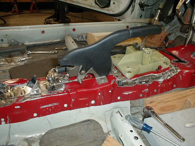

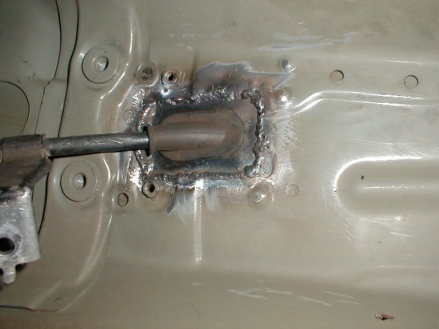

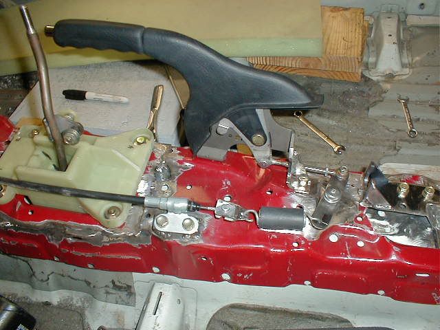

After purchasing a wrecked 97 Prelude VTEC with 90k miles off eBay and a theft recovery 94 GSR in Charlotte, the conversion process is now well on it's way. I spent most of the spring designing and planning the conversion and began the fabrication process in July.
I basically chopped the front end off the Prelude at the firewall and stripped it down to the front horns, shown here with the cross members and lower suspension arms mocked up.
P1
P2
After stripping the GSR down to the shell and shimming under the jack stands to get it level (I have no surface plate), these pics show the frame used to transfer measurements taken from the structure above into the back of the GSR. The frame is square and level so I could use a plumb bob to locate points from the Prelude front structure into the GSR and cut the hole.
P3
P4
P5
P6
P7
Note string down centerline. Very important to have everything centered and square so the car doesn't "crab" down the road. ;)
P8
This shows the cardboard pattern I made of the Prelude horns to help locate the cut as precisely as possible. I had to cut the shock tower out of the way to place the pattern square and level.
P9
P10
P11
The hole's been cut...It's on now!...No turning back :eek:
P12
P13
P14
P15
Sorry for the dark pic, but these next few show 97 Prelude front uprights (knuckles,spindles...) purchased from a junkyard adapted to the GSR front suspension for 5 lug hubs all around. This also gives me the large front brake rotors and calipers from the Prelude at all 4 corners.
P16
P17
P18
There are only two things I had to do to use the Prelude uprights. one was ream the lower ball joint hole in the GSR lower control arm to accept the larger Prelude upright lower ball joint. (holes are 7 degree standard taper, 1.5" per foot). The other was to drill and tap the GSR rack ends to accept the Prelude inner tie rods.
P19
I also converted the GSR power steering rack to manual by drilling a 1/2" hole in the rack and removing the piston seal and by connecting the fluid inlets in rack with tubing so the air in the cylinder can move back a forth freely as the car is steered. The 1/2" hole is sealed with a piece of flat rubber held by a pipe clamp.
P20
P21
No longer front wheel drive, thus no front drive axles, I used a 1" grade 8 fine thread bolt torqued to 192 ft.-lbs. to hold the preload on the front wheel bearings. There is a conversion formula to calculate bolt torque for equivalent tension load between two different bolt sizes and thread pitch. I also made a small bushing to hold the 1" bolt centered in the splined hole in the hub.
P22
This pic shows the cuts made in the quarter panel to flare it for the wider track of the Prelude. Otherwise the stock 205/50R16 tires on stock 6.5" wide wheels stick out past the quarter about an inch. I'll flare the quarters out 2" to allow for 16x7.5 wheels in the rear.
P23
This series of pics show front supports from the Prelude being fitted into the hole in the rear of the Integra...
P24
P25
P26
Frame jig used to locate hole is re-installed to locate the frame structure.
P27
P28
P29
Right rear wheel well with lower suspension arms installed to make sure wheel is centered in wheel well.
P30
Left rear wheel well.
P31
The process of welding the frame to the shell has begun and I've been working on adjustable upper control arm mounts. More pics of that coming soon!
Questions and comments are welcome and encouraged.
Thanks,
Dave
See less See more
