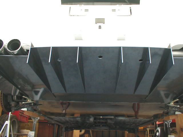

Post #DC2H22-108
These are pics of the rear diffuser and belly pan Iím working on. Iíve been fighting a bug lately and havenít made the progress I was hoping for to this point. Next step is to make filler panels around the suspension arms in the wheel wells.
Cheers!
Dave
