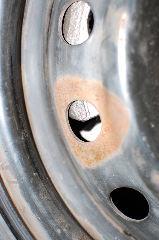

Confirmed that this brake upgrade will fit behind OEM 15x6 2004-05 Civic steel wheels. There's about 3mm of clearance between the caliper and the face of the wheel! Pics up soon.

Behind OEM 15x6 Civic steelies
