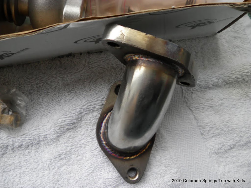

Here is a example of a couple different direction elbows so you dont have to grind
You could just change the direction the Waste gate is located-- I believe this is what Meltman is trying to show you. GL

Ah ic, but if you check out the first picture, my log style already have something like that.
