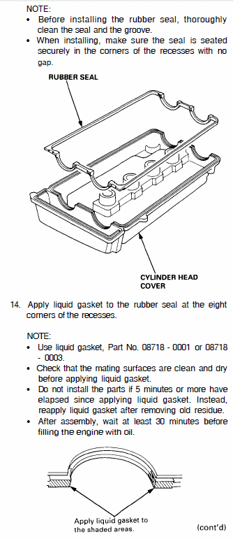

I have that same problem. I just bought a valve cover gasket alont with the spark plug seals. Would anyone happen to know if the grey gasket sealer is good to use for the sides of the gaske on the valve cover?
Use "honda bond", any honda/acura parts dept will have this.

We dont have A honda here in town have to drive like 50 miles. So that sealer i have isnt good?
I don't know what sealer you have but yes others will work. The sealer, should NOT dry hard, it needs to stay semi flexible.
Something like this from autozone will work

This is the one I got.
Permatex Rigid High Torque RTV Silicone Vacuum Equipment Gasket Maker
That will more than likely work, but if it was me I wouldn't use it. It looks like it would be a bitch to get off next time you replace the gasket. The valve cover is not a high torque area, and this is why it does NOT use a hard/rigid gasket sealer.
